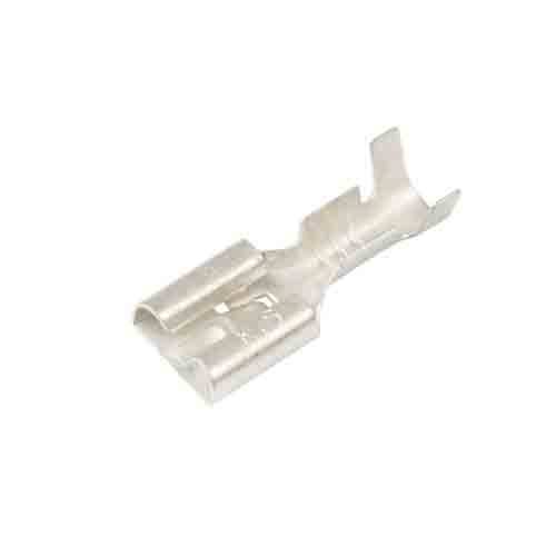

MoPar terminal

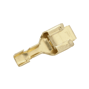

Packard 56 terminal

MoPar terminal
Packard 56 terminal
