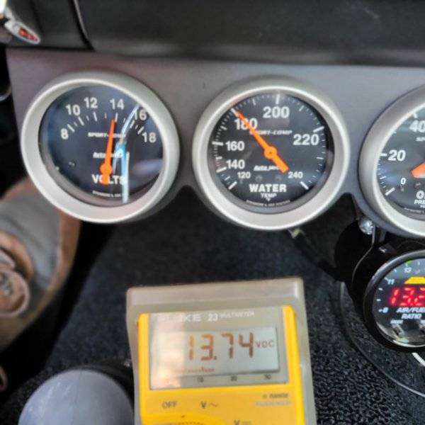

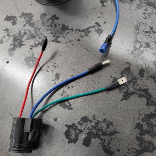

Looking for some advice from anyone who has converted their alt over to the Denso style and measured the voltage output afterwards. Trying to understand if things are normal or out of whack. Put this setup on my car on Sunday. I have one of my good Fluke meters along side an Autometer volt meter in the cab to verify #'s. The car had been sitting for a couple of weeks. Started it up and it was charging at 14.3 initially. After driving about 5 miles it dropped down and settled right at 14 and stayed there for the remainder of the drive, about 20 miles. Perfect, I thought. Tonight I jump in for another trip. Went to a hardware store about 12 miles away. Started out at 14v and slowly dropped to 12.3v. Varying engine speed didn't change anything. Was in the store for 5 minutes. Started it back up to come home. Now it is putting out 13.68 - 13.8, which is perfect imo. So aren't these things supposed to be fairly stable and consistent, or will the output vary like what I am experiencing?

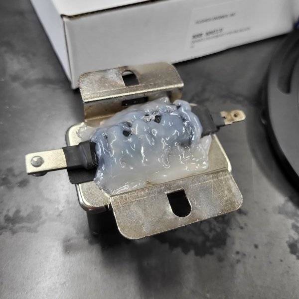

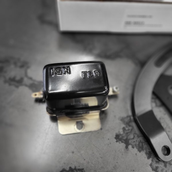

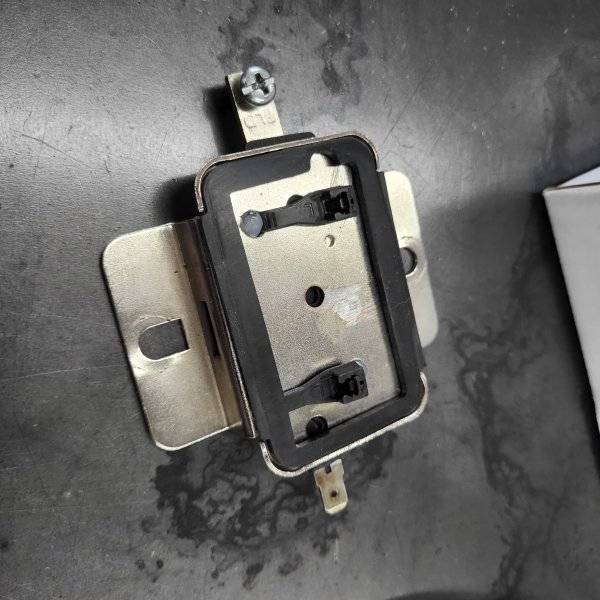

I am positive the alternator is grounded good. For the 12v switched wire, I removed the guts from a stock style 69 and older electronic voltage regulator and tied the 2 terminals together. Then used the original green wire that went to the alt for my power. Ran another wire back to the starter relay for "sense". I replaced the ignition switch earlier in the year with an older nosr usa version. I'll double check all connections again tomorrow.

Battery is only 1-2 years old. I ran the sense wire to the starter relay main stud with a fusible link, which is also where the #8 alternator charge wire is. The MAD bypass deal.
My blue wire goes direct to battery.
My green wire goes to the bypassed vr
The bolt on alt wire goes to my starter relay via fusible link.

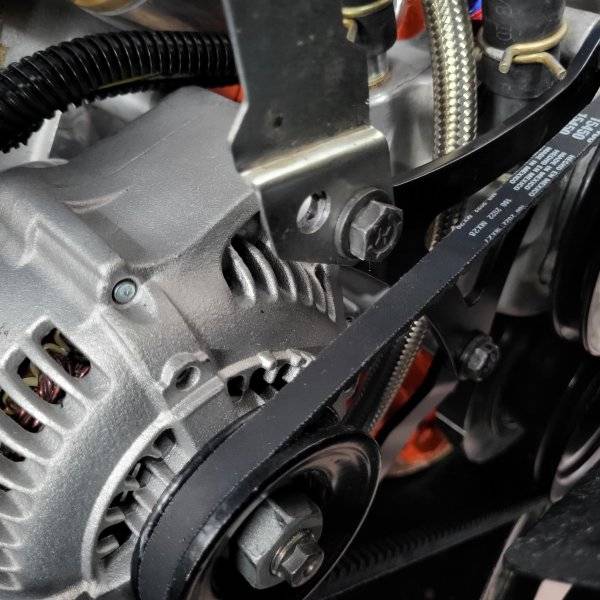

Well, in case anyone is wondering, apparently I had a defective alternator. No surprise there with the way my luck goes on these old cars. Went and bought another alt, swapped it in without touching anything else and it charges at a steady 14.1v.
Best upgrade I ever did. Bought it from Mancini's.
