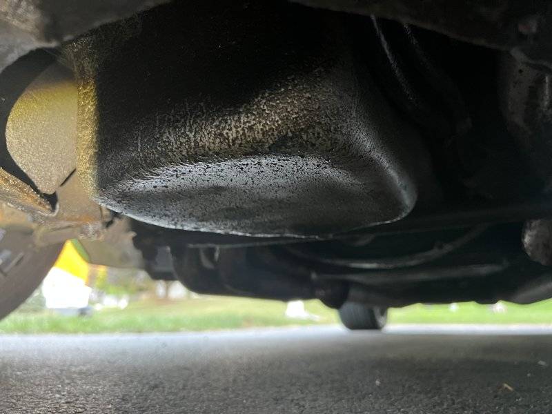

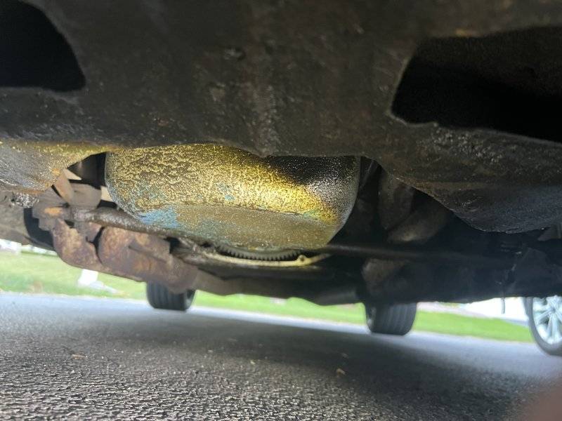

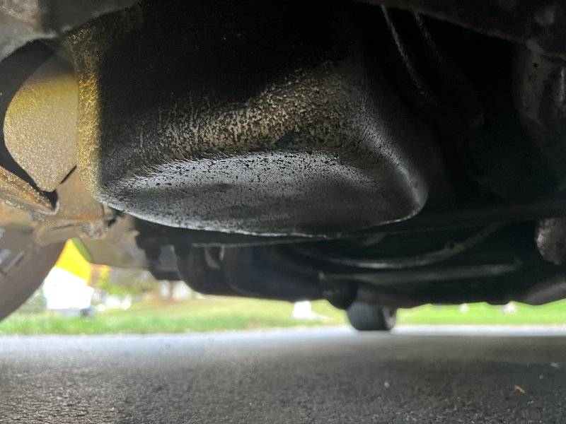

Dented oil pan going over raised manhole cover. Immediate replacement or can it wait until winter?

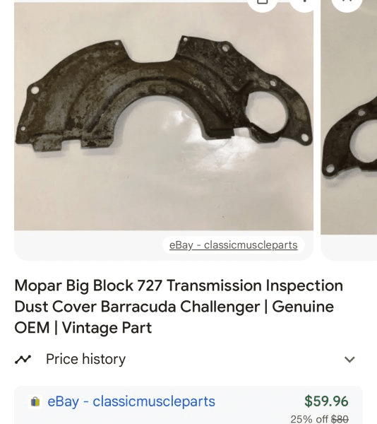

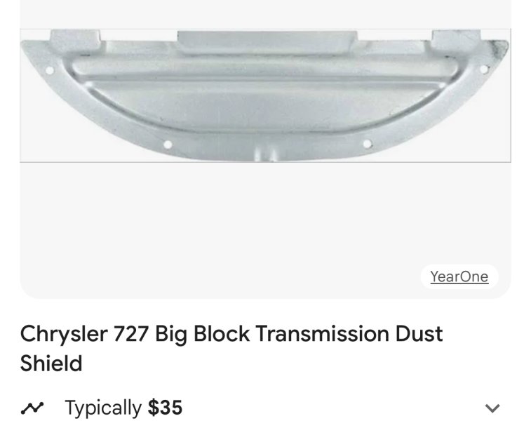

You're missing the dust cover/ inspection cover at the bottom of the bell housing.
It extends beneath the starter as well, so someone left it off.
Don, any idea the risk of using a aftermarket dust covers that I can slip on without needing to take the starter off? After browsing for awhile it looks like these are my only two options…plus it looks like neither come with bolts.
Hard to tell the depth from pictures without a straight edge across it. Not sure a stock oil pick up has a lot of clearance to the pan bottom.
IMO, it would be a good idea to pull the pan especially if you know the pickup is close to the bucket bottom. If the pickup screen is breached, it may be possible for the oil pump to pick up debris large enough to lockup your oil pump.............. at any time in your travels.
Might also be good to get the cover back on the trans.

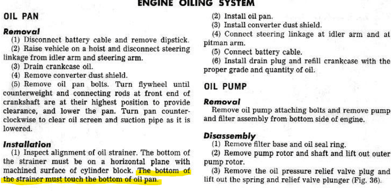

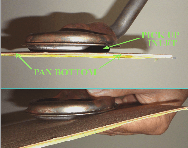

It may just be me but I can’t see having the strainer bottom touching the bottom of the oil pan (in yellow). A 1/4” of clearance sounds much better to me.
With the factory pick, I make mine all touch.
@AR67GTX Look over post #9 again. The service manual says to have it touching. I've seen and imprint of the pickup in the residue at bottom of the pan many times. Doesn't hurt anything they have a cut out in the factory pickup for adequate oil flow.
I think you’re worrying way too much about nothing. If it bothers you that much, drop the pan. It’s only a few bolts.

To the OP: That's not much of a dent. You're fine.
I did much worse with a floor jack and then looked inside with a borescope. It was not plugged/obstructed. .
I read it right the first time and understood. I’ll stick with the aftermarket suggestion of 1/4” in case of the random oil pan dent as in here, and to be sure it has plenty of suction area.
I believe the aftermarket suggestion is for an aftermarket pick-up that is a completely different design. Those do need bottom clearance.
You didn't mention your engine but yours looks like the BB 727 version (the easy one)...the first picture in the ads you posted..
They take four 1/4-20 bolts half or 3/4" long.
