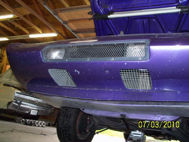

don't ferget that there are 2 more openings under the nose besides the main grille opening.....
Race Daytonas had a similar screen under the nose to keep the Fords from clogging the radiator!
