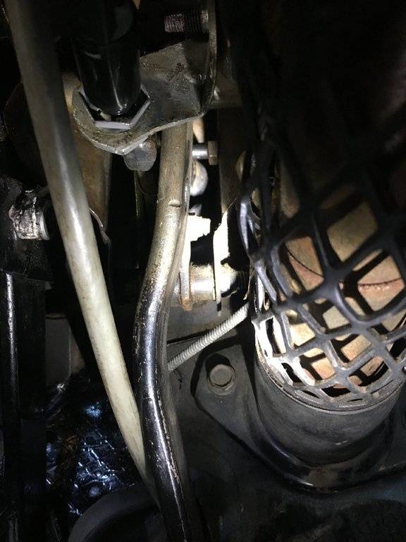

So Ive been trying to get the booster off. What a PITA. Ho do I get the bolt the goes from the brake pedal to the booster out? It hits the side of the brake assembly bracket?
On another note, the valve that goes into the booster from the dome I changed with another I had as it seems to work better when I was blowing through it. Brake pedal was still hard but when I took the valve out there was pressure on it? If the diaphragm was cracked would this still have pressure? Or could I have a problem with my distribution block and not the booster?
I just changed the one in my challenger,took maybe a hr.
I thought It would take me about an hour too lol. 4 hours later and its still in there tho. Here is a picture of the bolt I cant seem to get out, the nut is off and it slides over until it hits the side of the brake assembly.
