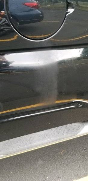

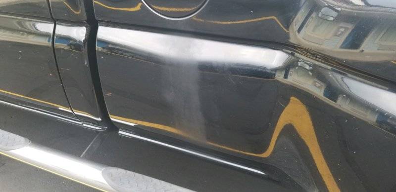

Can I get some advice on removing or repairing the fogged up area on my dually due to diesel spill.
The diesel has chemically attacked your clear coat. You could try to buff it out with rubbing compound & see if there's any good clear coat underneath the "hazing" left, but my guess is you'll have to re-clear coat the whole area....and try your best to keep diesel off of it (sorry)
Thank you I really haven't tried anything yet just wanted to get a direction to go first.
