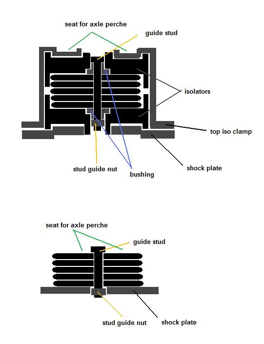

The rear suspension on 73+ are different also as they have isolated rubber mounts surrounding the leaf springs.
go here for good pictures:
http://www.forbbodiesonly.com/moparforum/showthread.php?t=17072

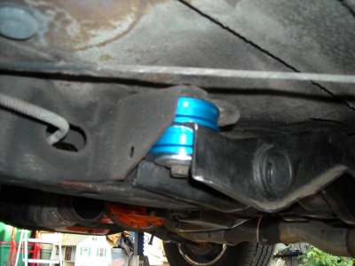

Can you just switch that mess out for a 71-72 setup?
Why do you want to go backwards in handling and ride???
For better handling go to a bigger torsion bar and stiffer shocks, I have poly bushings and my car handles pretty good.
If you're going for handling, solid bushing replacement makes a huge improvement.

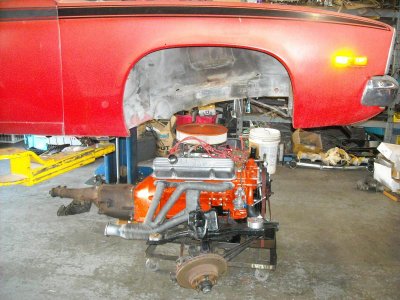

Outside of that, the two suspensions are different. Lower balljoints changed (hence the change in lower arms). Upper arms attach to the K-frame and not the inner fenders like the earlier models. The torsion bars are longer because they go through the trans crossmember brace and attach to their own crossmember.
In the rear, yes.
In the front, no.
The unibody is COMPLETELY different firewall forward (and a few points back) in 73.
In 72 the inner fenders are welded to the frame rails and the unibody. In 73 they became a bolt in design. So there's no shock mounts on the 73+ unibody. Like Revhendo said, the UCAs don't bolt to the unibody either.
The trans crossmember is just that in 73. They made a separate Torsion bar Crossmember just for that duty.
Which is better? 72 down or 73 up? Personal preference. In a performance application, the 72 down wins. Cruising with a numb like ride? then 73+.
The 73+ suspension can be tuned to perform, its just a different animal than the 72 down.
In the rear, yes.
In the front, no.
So very true. I have taken the iso bushings out of the front of my bird but have not done the rear yet. You can feel the difference between the two. Where the front feels appreciably solid, the rear still has a bit of a mushy feel.
Hmm... Curious if it is even worth it to keep the charger then. Might just flip it and get a 70-72 Dart. Those things handle amazing when you do a little suspension work on em.
Depends on if you like the car or not, or what your purpose for the car is going to be. It's just parts. You could go the A body route, but then you're looking at different parts. Big bolt pattern disc conversions, rear brake upgrades, torsion bars and rear springs. Pretty much just parts, but different parts. (Yeah, I own a 2dr 69 Valiant, too).
I love my '71, nice solid feeling.
My brothers '73 felt like we were riding on marshmallows, HUGE improvement with solid bushings on the front and removing the iso mounts on the rear. Can't see how the later suspension was any kind of improvement :confused3:
