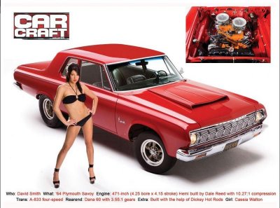

Here is what I am talking about. I don't know if they all had two headlights or if it was something for racing?
Not the girl ... the car ... I'm talking about the headlights on the car!

The dual headlights on the Savoy in the pic of my previous post ... could that be part of a factory "lightweight" package for the '64 race-hemi cars?
Ask for a pic- I get one! I have never seen a single headlight 64 Plymouth. I have seen several single headlight 64 Dodges. ...............................MO
64 Hemi cars were single headlamp. Same grille, with a cut out section covering a trimmed headlamp bezel. Savoy, no body side moldings or center trunk molding. Same horizontal trunk molding as a Fury. All Max wedge sedans were Savoys. Belvedere, thin body side moldings. horizontal trunk trim stamped "Plymouth". Sedan or H/T. All max wedge Belvedere's were H/T. Fury, H/T or convertible, wide side body trim. Note the holes in the body are a different height than a Belvedere. The trim can be mounted in the Fury holes with retainer modification. Sport Fury, higher interior trim level, buckets, console. All 4 door body's can be built into 2 door sedans by using the 2 door doors, moldings and interior trim. The B-Pillar needs to moved back and the 1/4 panel patched in the rear door area using the rear door parts. H/T doors can be converted to sedan doors.

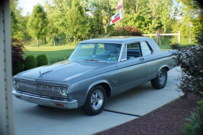

Clone...sorry
Did ya! notice the flags in the back ground?
