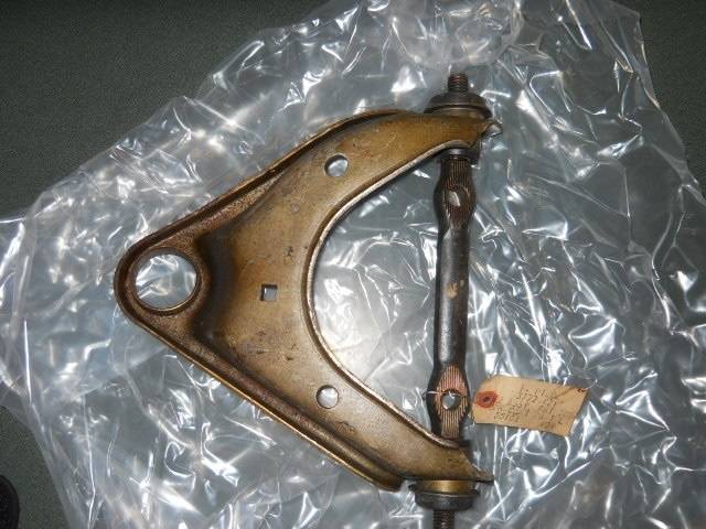

73 up B body Mopars changed to a totally different UCA design with a "shaft" installed thru it.
Won't work at all on 72 on down, earlier cars.
(See photo)
(See photo)
Thanks for the pic! Never have worked on a 73 and up B but have worked on the E cars which are all the same as the 72 and older B's. There's always been a fog on this subject with many not knowing exactly when the change was made and even though I've read about it several times over the years, my mind is now clear on it....I hope! :D

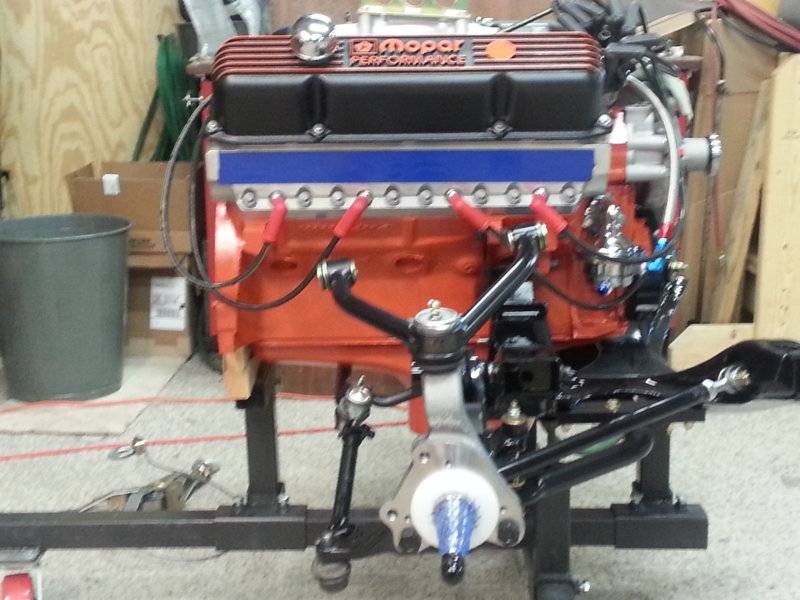

My '71 here. I went with tubular UCA and spindles for disc. Some kind of visual in reference to Moparmarks statement. Cheers
