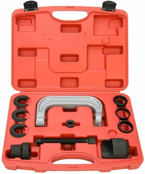

Although I'll add that changing those UCA bushings an the 73 and up arm is quite the exercise and is not documented in any FSM.
Back in the day you were advised to "replace as an assembly" which is not an option today.
There are proper bushing replacement, and removal, tools by lots of tool manufactures to get that job done.
Nothing hard at all by anyone that is competent in doing suspension work.
Pretty sure that tool won't do the job.
Nothing accounts for the bar through the middle.
Tell me, and others why the bushing tool kit doesn't do the job?
Tools like that have been in existence in professional repair shops for decades.
Bet you could find lotsa You Tube videos mechanics have posted, getting the job done, with using those tools.

Yes, bushings can be R & R'd with your method, store bought bushing removal tools, using a Dremel, using a die grinder, cut of wheels, torching out the bushing rubber, using an air hammer, hydraulic press, or whatever tools a mechanic has on hand in comfortably getting the job done.
Me, and shops, that i worked at, had proper tools for doing lots of suspension work, repairs, to get the job done, and out the door.
Lots of ways to get the job done.
Whatever floats your boat, as long as it works for the end result.
