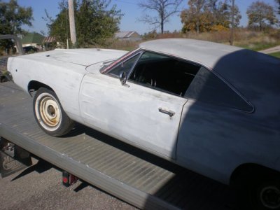

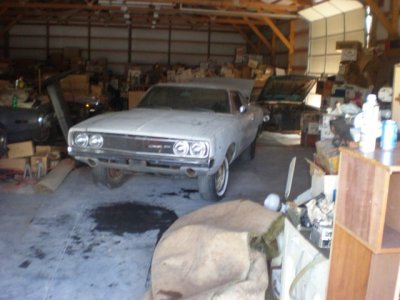

yup my 69 charger 500 had 68 fenders and doors on it when i bought

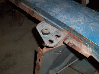

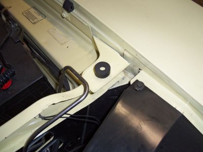

I have done this except using a 69 fender for a 68 charger. There is one other slight difference, the corner bracket from the inner fender to upper rad support is different. The 69 has the bracket as a part of the fender and the 68 has the bracket spot welded to the inner fender and upper rad support. You will need to save the bracket from your original fender and attach it to the 68 fender. a101_0248.jpga101_0249.jpg
