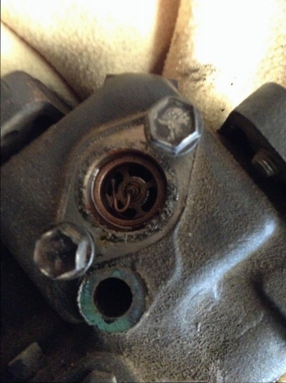

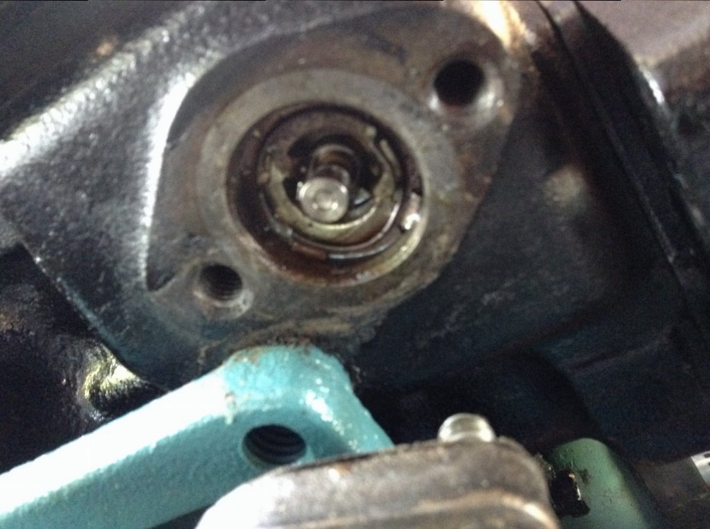

So can I swap the EPR stuff out for my thermostatic piece? Would I be better off getting a new compressor? I was gonna say my original had some kind of elements or something in that port that led me to believe it had something to do with temps but wasn't exactly sure how to word that.
These are pics of what I am working with. The one with bolts in the housing is my original compressor. The other is my replacement. Can this EPR stuff be swapped?
That's two different types of EPR valve. Yes, they're interchangeable; see pics of all three types here. But they're also fault-prone and capable of causing aggravating problems big and small if they're not in good condition; if you're using R12 refrigerant and you are bound and determined to keep the system in its original configuration, you should seriously consider installing a new one (same page as what I just linked). If you're going to R134a refrigerant, or you are staying with R12 but don't necessarily require the system to be exactly as originally shipped, remove the EPR valve altogether and install a thermostatic clutch cycling switch instead, per discussion here and here. Options in clutch cycling switches are discussed here (sorry, pics no longer load -- I'll try to fix that next week)
