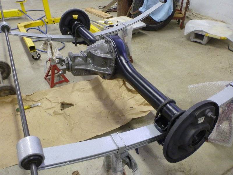

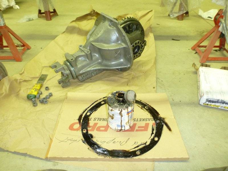

No plans to ever take it apart again and I hate leaks. Stock paper gasket and Aviation Gasket sealer on both sides.
