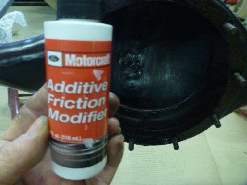

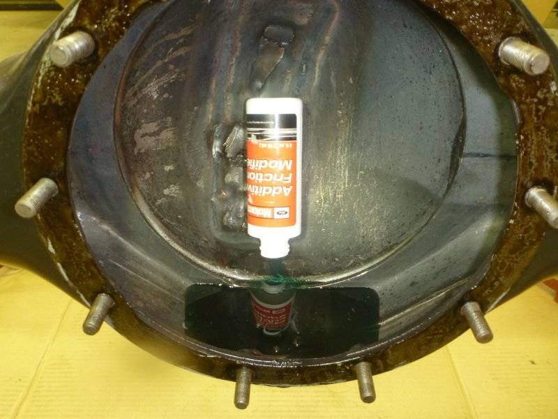

The 80-90 should be fine. If you have the clutch style limited slip, you want the friction modifier too. The Ford style works really good, maybe Mopar if they still have it.
Dino oil, and Motorcraft friction modifier. No synthetic!

I use what Cass, aka Dr. Diff recommends. Super Tech 85w-140 conventional gear oil (sold at Walmart) along with a bottle of Ford friction modifier.
