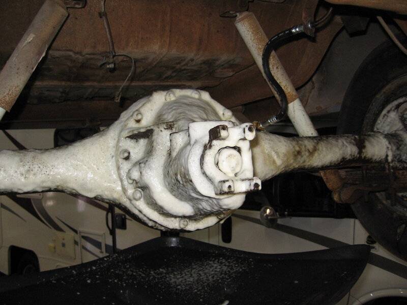

Greetings. Absent for a long time here. Unmolested 69' Charger being brought back to life, been sitting for 30+ years. 69 8 3/4 489 case absolutely buried under hardened and crusted s**t that appears to have puked from the vent decades ago. Chunk and both axles recently removed. Recommendations for cleaning? If I immerse the carrier assembly in gasoline are there any internals that will not react well? Last question.... the axle housing and the carrier externals were painted white for some reason; anyone know if this is a factory thing or just a previous owner who didn't like the normal black?

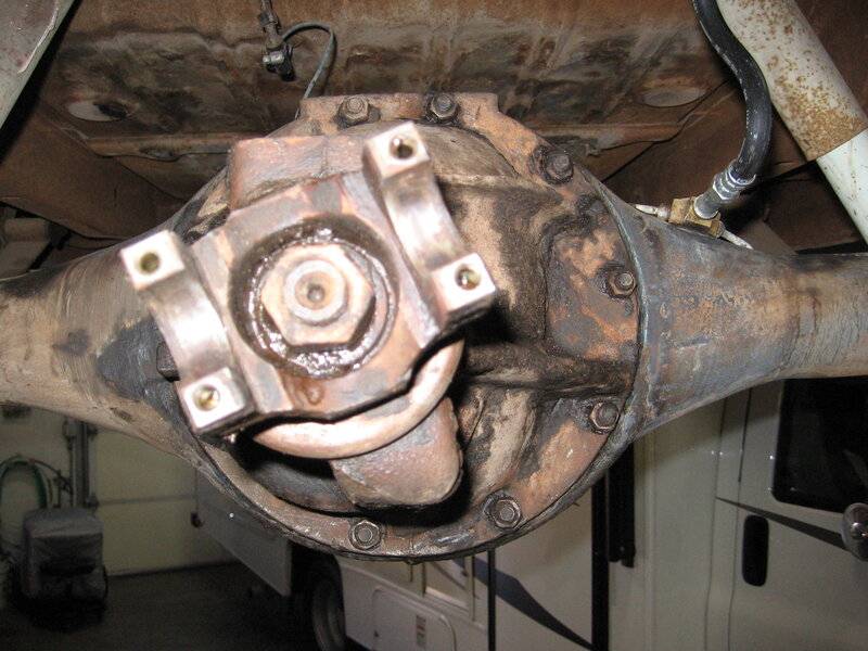

I hear ya about buildup.Mine came from Tucson AZ. Dirt like concrete.Got it pretty clean taking off the heavy stuff.

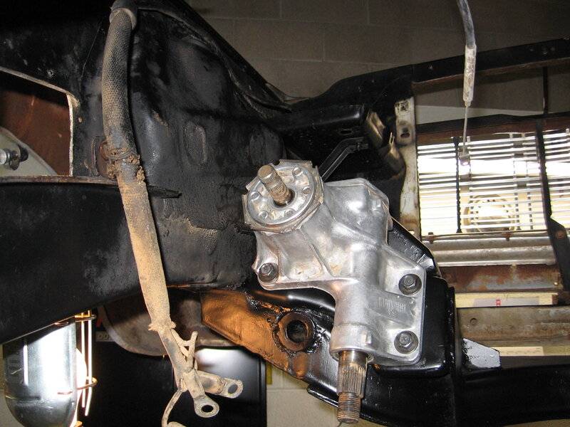

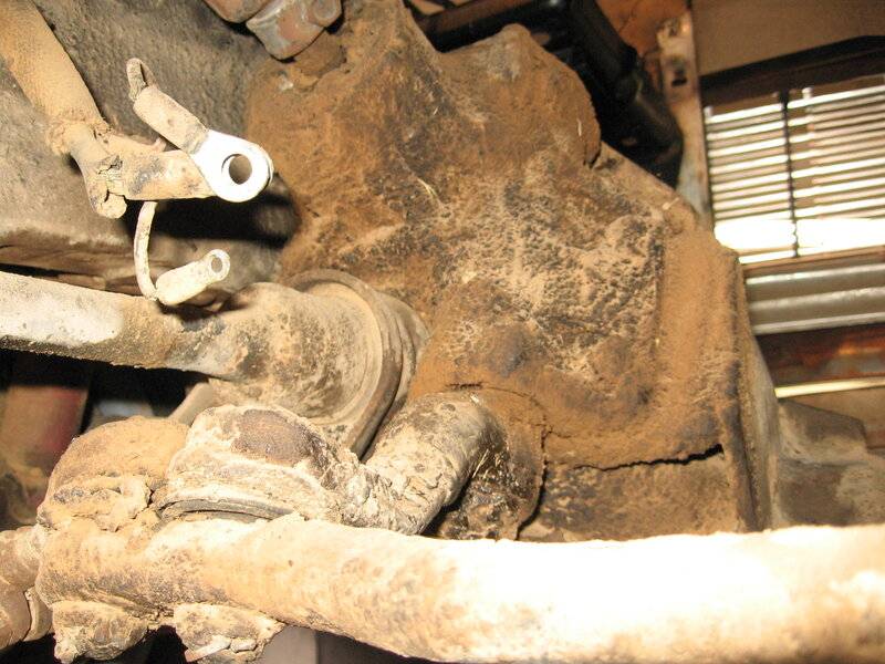

This is what the steering box looked like. Before and after.
Never heard of white paint.
Most raw or maybe a splash of black paint. White was a 70's thing.Don't forget the Peace sign on the back of the housing !

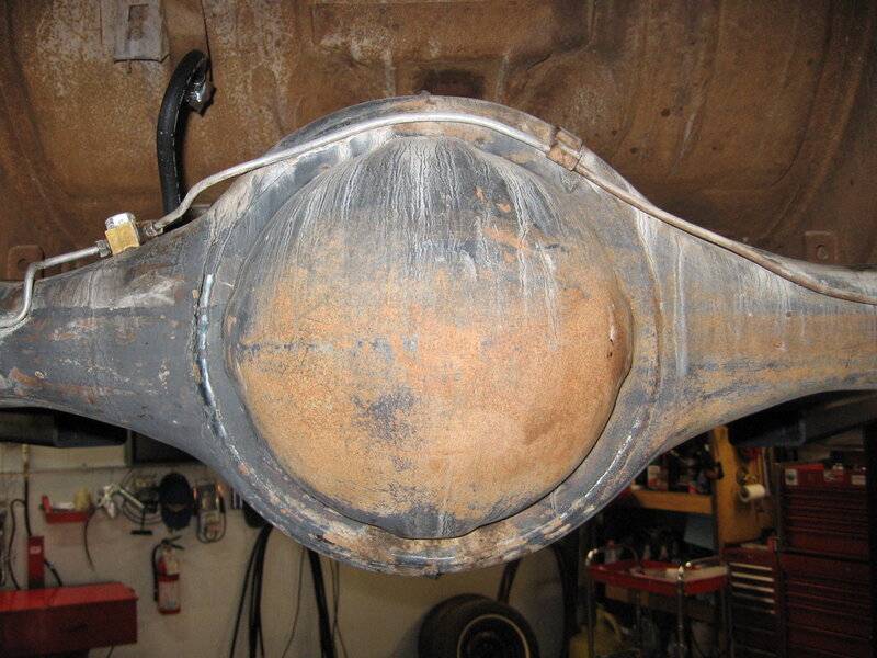

Oven cleaner worked good.Didn't have a pressure washer, just a hose. You can finish off with Simple Green or I used brake cleaner before painting.Inside Like OldBee above wash out the gears bearings and housing with kerosene.
