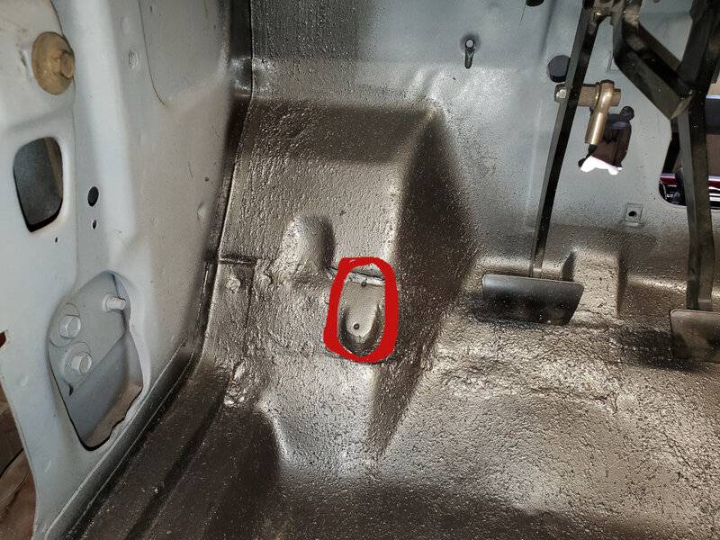

I have another one for the pros. I want to screw in my dimmer switch but I’m not 100% sure where. I think it should be just above where the floor pan meets the fire wall. But how about in relation to the emergency brake cable tube? I think someone had patched the floor and never replaced the switch. Any pointers?

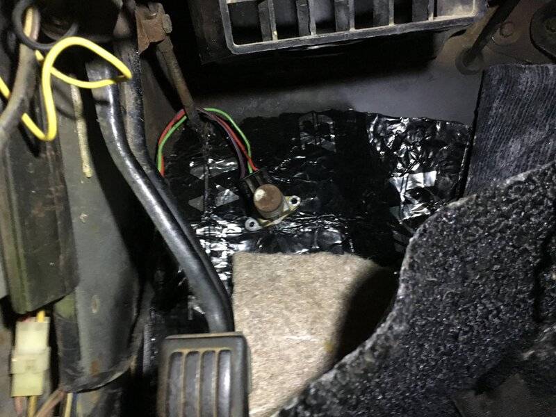

There should be a hump on the floor pan that matches the contour of the switch. It mounts there with the plug facing the kick panel.

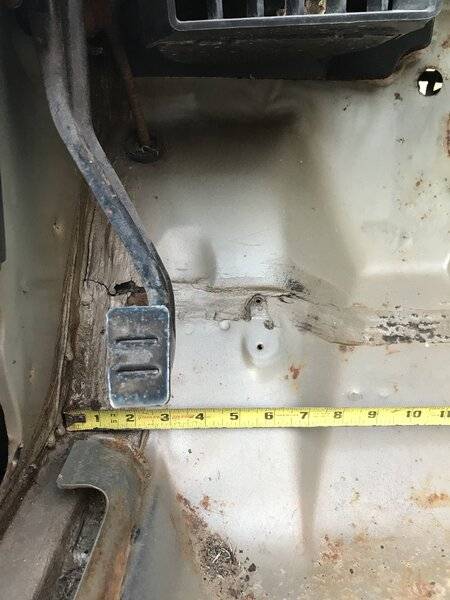

A pic of what hemibee described, mounts to the two little holes at about the 6" mark.
Alright thanks fellas! I’ll just have to cut the sound deadening out and hopefully find that recessed part.
