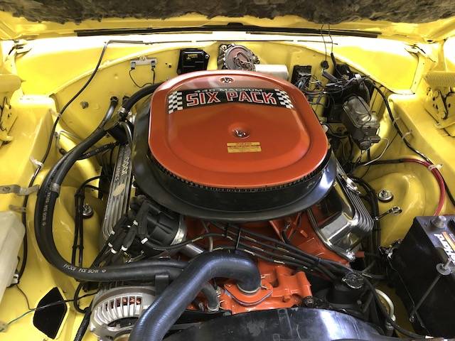

Paint them with Urethane. Holds up great on iron or aluminum. Intake, heads, water pump and valve covers are all aluminum.This engine was painted in 2012.
Doug
Doug
What brand of paint did you use? That looks really good.

I'm with dvw Doug. I used the Urethane and epoxy primer he recommended and love the results. Much harder than anything I ever used out of a rattle can and not bothered by fuel or oil. I even did the short block with a roller and brush in the car!!
Paint them with Urethane. Holds up great on iron or aluminum. Intake, heads, water pump and valve covers are all aluminum.This engine was painted in 2012. Doug
This engine (Doug's) pushes my happy buttons just looking at it!! I'd love some links to hear it run!!!
WITNESS THE BEAUTY OF THIS BEAST!
I was considering that Indy intake with a 3x2 top .....until I got my Weiand P3690982 6bbl intake.
Doesn't it come setup for MaxWedge ports?
