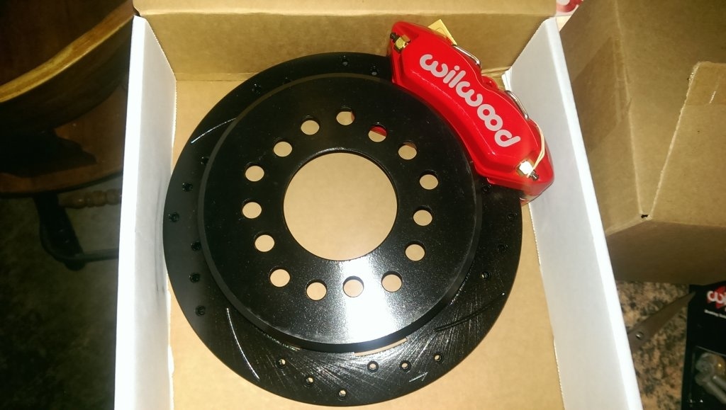

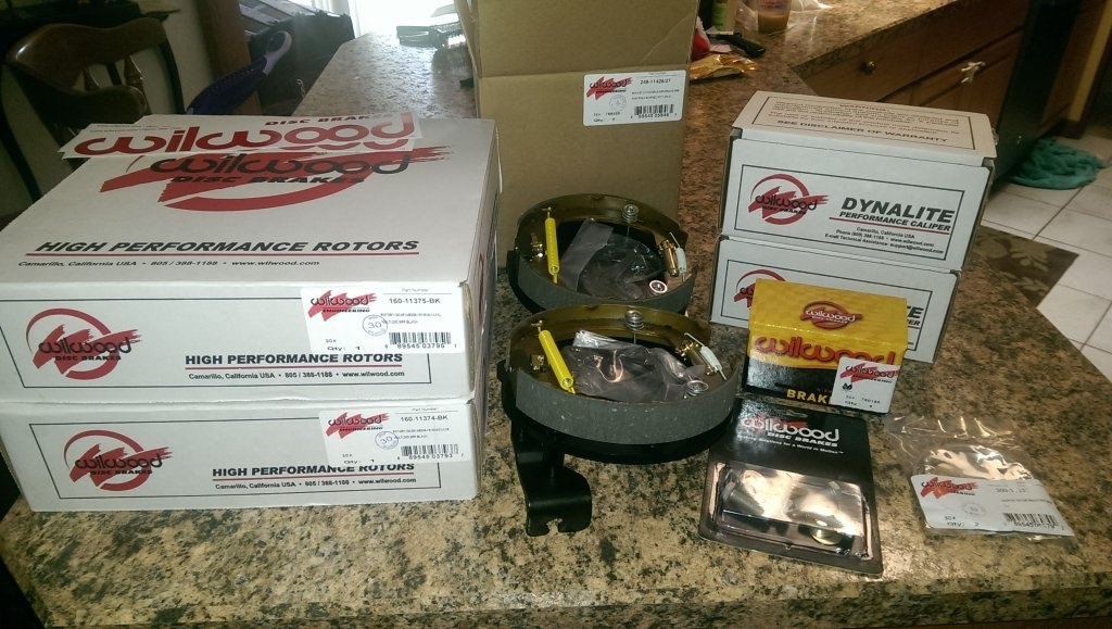

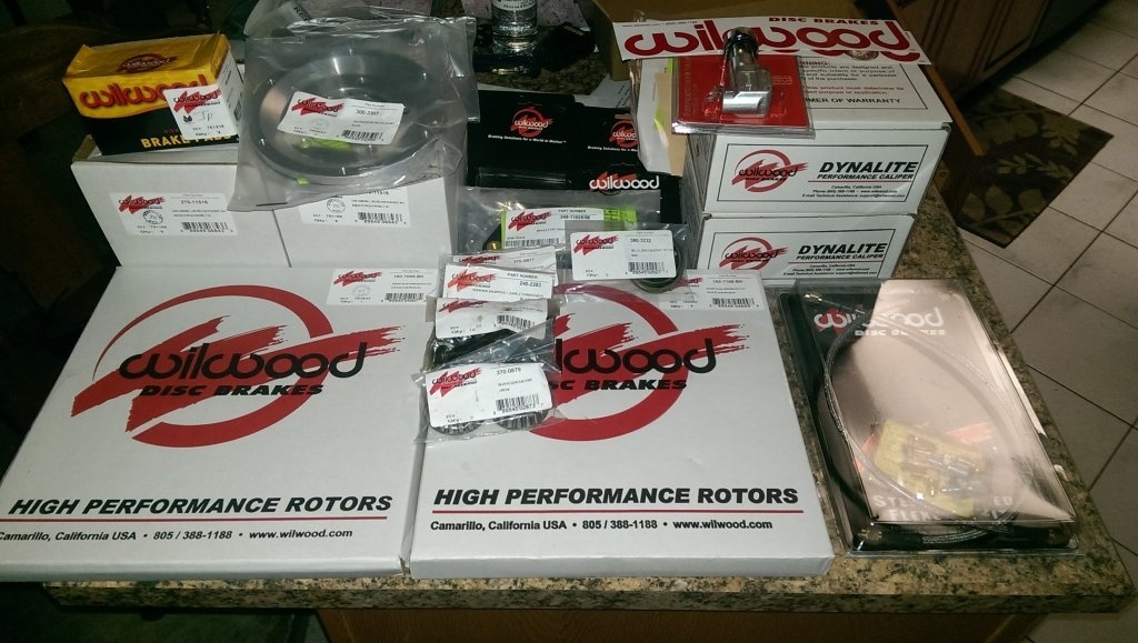

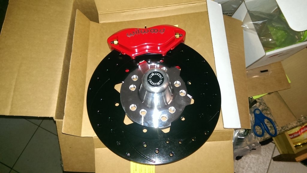

I bought this setup from elitevintageauto.com
It was a little bit more then you said you want to pay but I bought a better then basic kit so there's a cheaper kit
Or I was told you can put 33rd gen b body front disc brake parts on those older cars to convert to disc up front .
