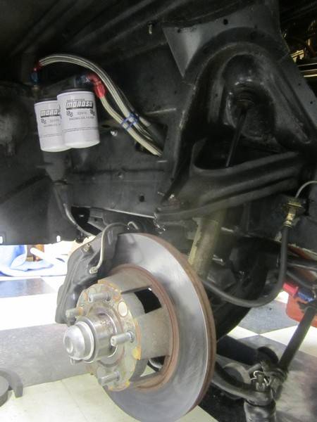

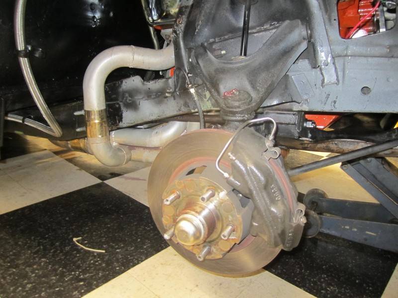

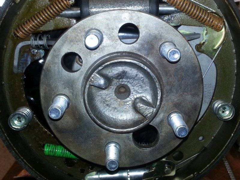

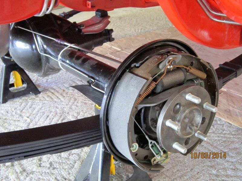

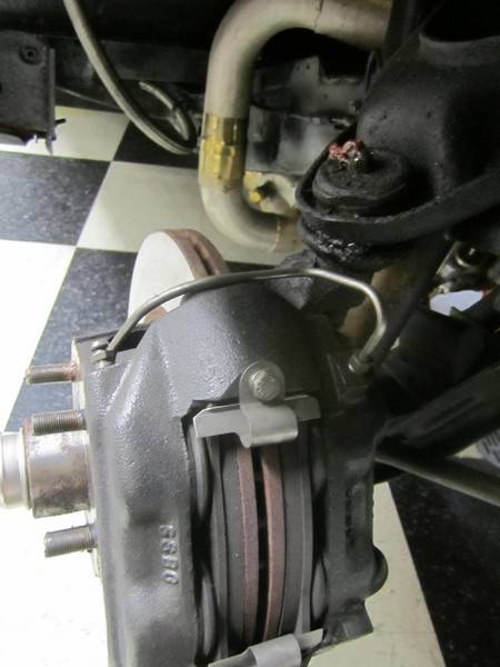

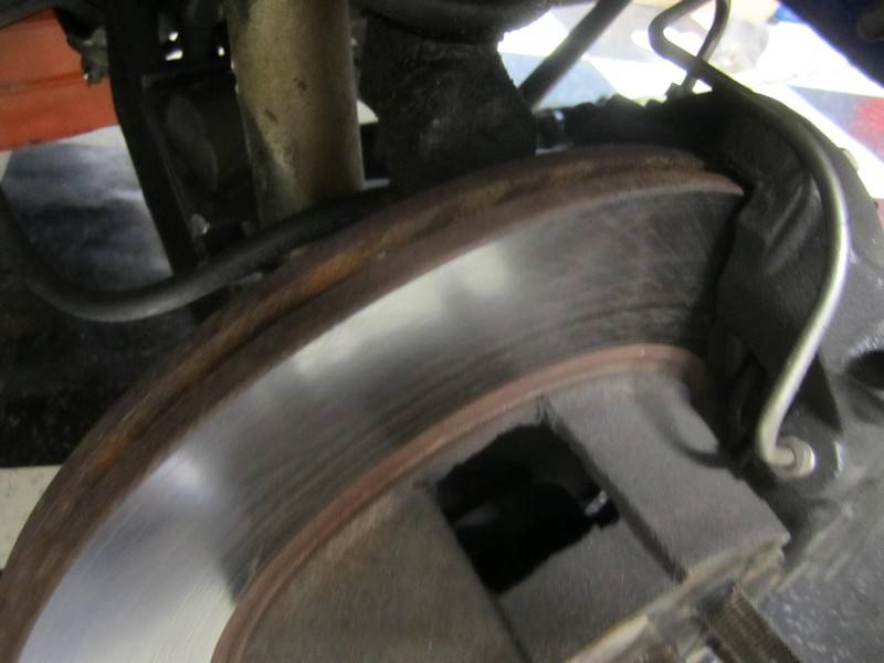

As mentioned Dr. Diff or even Wayne "The Ram Man". BOTH are very knowledgeable and know their stuff. I have a '71 RR with power drums. I went with Cass, A.K.A "Dr. Diff" for my front disc upgrade and they're OE 11.75" front discs from an A-body or Diplomat and parts are readily available still. Dr. Diff's kit is complete and if in need of info or am missing something, he is the one who often answers the phone. I kept the rear drums and rebuilt everything. I'd source the Midland power booster and have it rebuilt. I don't like the aftermarket boosters just because they're more than likely a GM little 9" booster:wtf:

I went to Dr. Diff's web page and I am liking the set up. I like that the proportion valve is an OE style. Thanks!

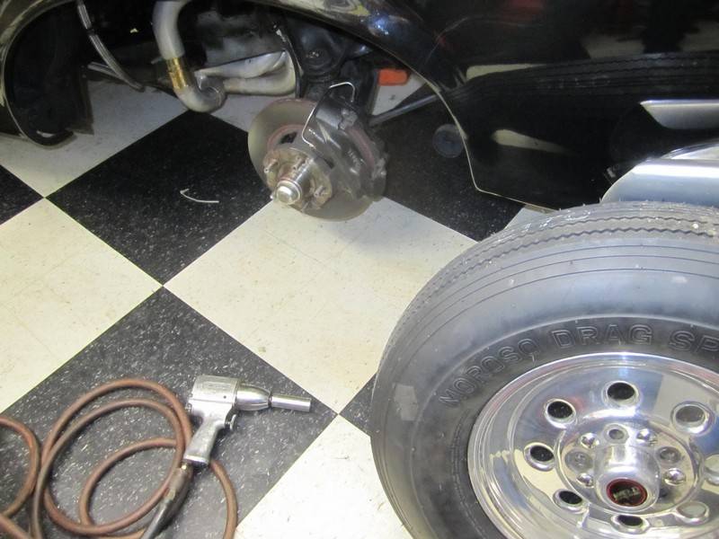

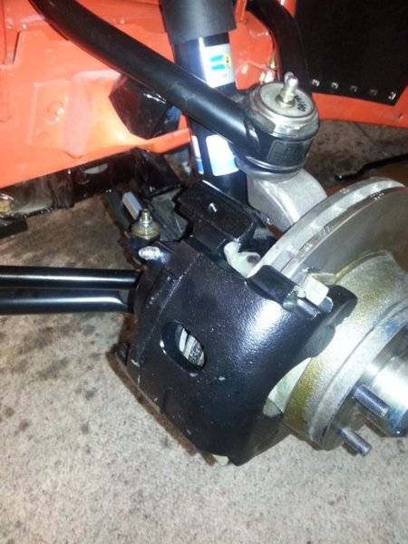

With so many choices available it depends on your wallet,,,,how much you weigh,,and how fast the car is.How is the car driven??
I have the SSBC front manual discos and dana drums out back,so rear disc is in my future with the speed I'm going.
