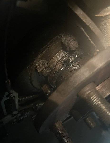

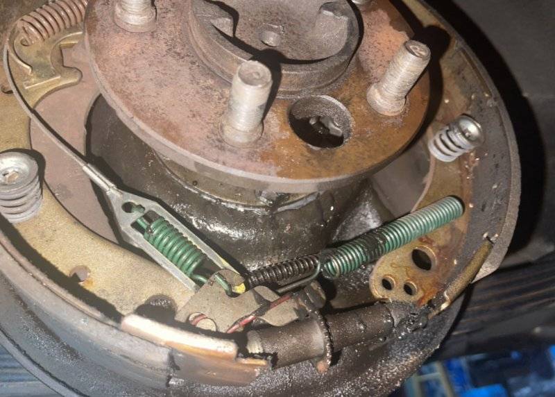

Need to use “no fling” grease, mopar had a special grease that would not work out around seals. Regular wheel bearing grease will just make a mess. I think Lucas makes a farm implement grease with similar “no fling” properties .
The seal leaking that much may indicate more trouble. Check the end play adjustment of the axles as well as the bearings for wear.
Replaced with green bearing in March no problems since. All good

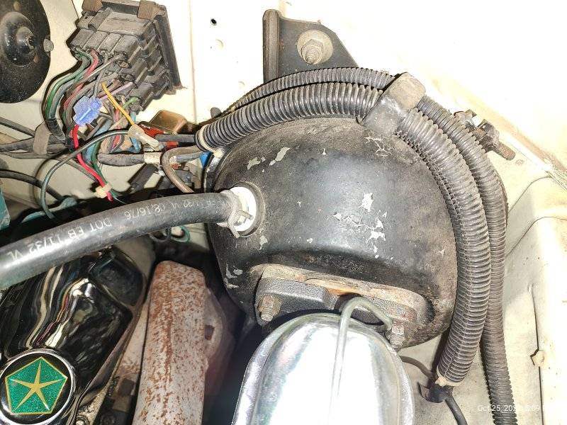

After considerable thought, several eyeballs on the issue, and consumption of a couple of barley pops, I'm about 93.527% certain that the booster is the issue. It is original to the car, when it had power drums. Just not enough "oomph!" and not enough feel. So, I am calling Booster Steve today and see what I can do to get a proper booster, or if he can convert mine to work with discs.

I have the original Midland booster on my 64 Fury that I recently converted with the Dr. Diff kit. My booster works with it. It sounds like your booster just needs to be repaired.
When the booster comes back to me, I'm definitely installing a heat shield at the inboard two fasteners to the M/C and the booster, to add a bit of a heat barrier for the M/C. Just an added layer of protection for the brakes, IMO.
