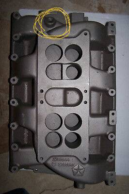

I don’t know about Hemi intakes but my 440 has a pipe thread tap into a runner behind the carb. Then a nipple out of that.
Something like this.

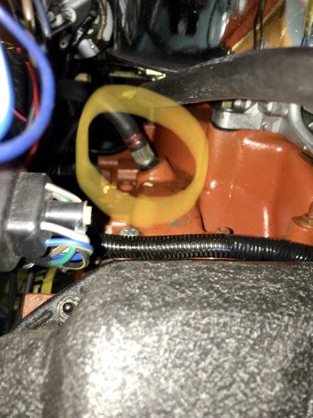

I have a 66 Street Hemi in my 67 Coronet. My booster vacuum line
is on port directly on intake rear.

As the other guys have posted the power brake comes from one side of the intake.
Are you sure the manifold does not have a port and you missed it?
Most cars that could have power brakes would have the port.
Hard to imagine they would bother having two separate intake manifolds.
I ended up removing the primary carb, removed what appeared to be a 3/8 core valley plug that was pressed in , tapped it out for a brass nipple and used this for pcv. I used the manifold tap for the booster.
