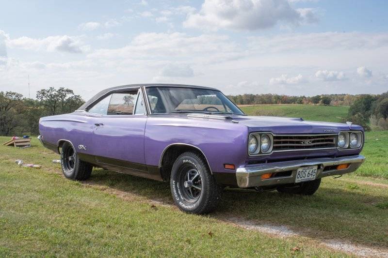

I have a 69 GTX and was thinking about converting my front power drum to front power disc, I currently have a 14" rim up front and a 15" in rear, I am hoping to keep the front 14" rim, is there a front disc conversion that will work inside a 14" wheel? I am having a tough time finding that information. Any help or advice would be greatly appreciated
