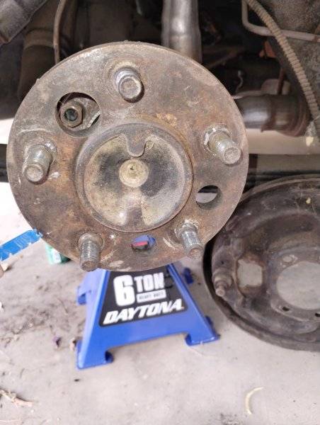

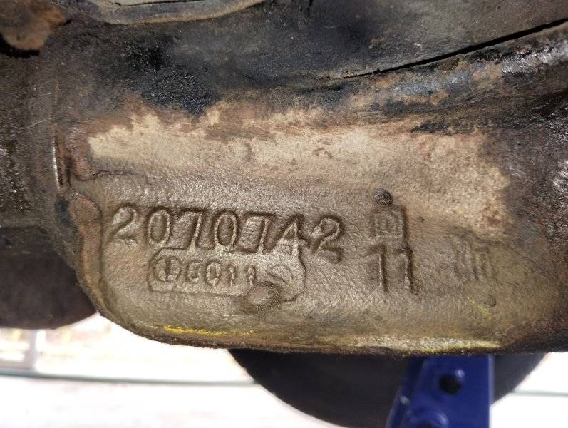

I'm looking at going with either of these kits for an 8 3/4 rear end. So from the research I've done and casting numbers on the axle I'm pretty sure that's what I have, but if anyone can confirm that from these pictures it would be appreciated.
(This is what I have with the tire taken off)

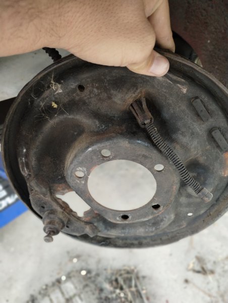

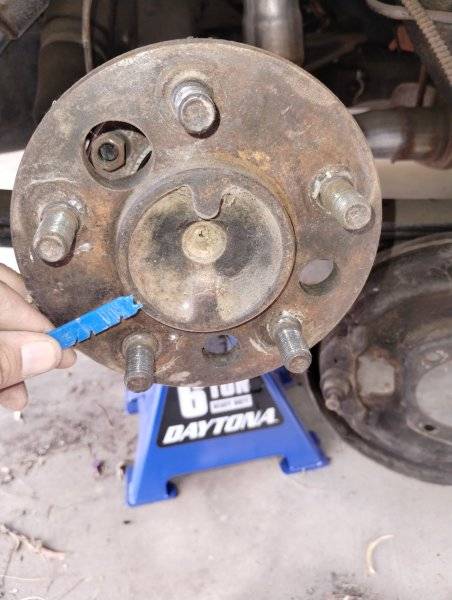

Now the brakes from Jegs mentions needing to measure the axle hub flange to make sure the rotors will fit on the axle. The problem I'm having is that what's under the tire doesn't look like the picture that shows how to measure it to make sure the rotors will fit. However the picture does look like rotors that are already installed on the axle but since I'm a novice when it comes to all this I can't say for sure.
I really want to make sure I get the right kit and do it right the first time, so if anyone can let me know if what I'm pointing at is this picture is what I need to measure the inside diameter of, or if it's the thing in the picture that has my hand in it, or if I'm missing parts or just anything that I might need to know it would be greatly appreciated.
