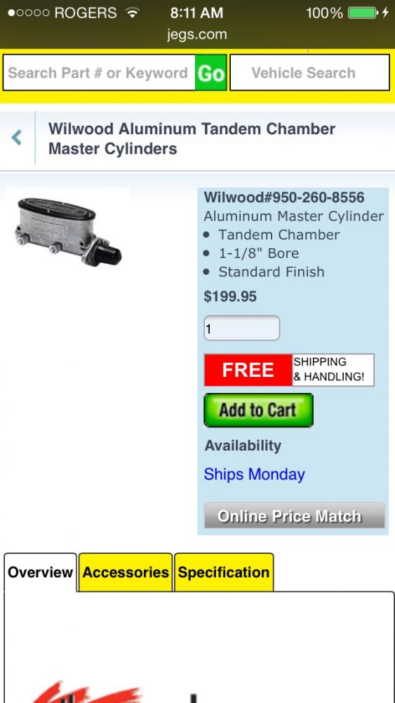

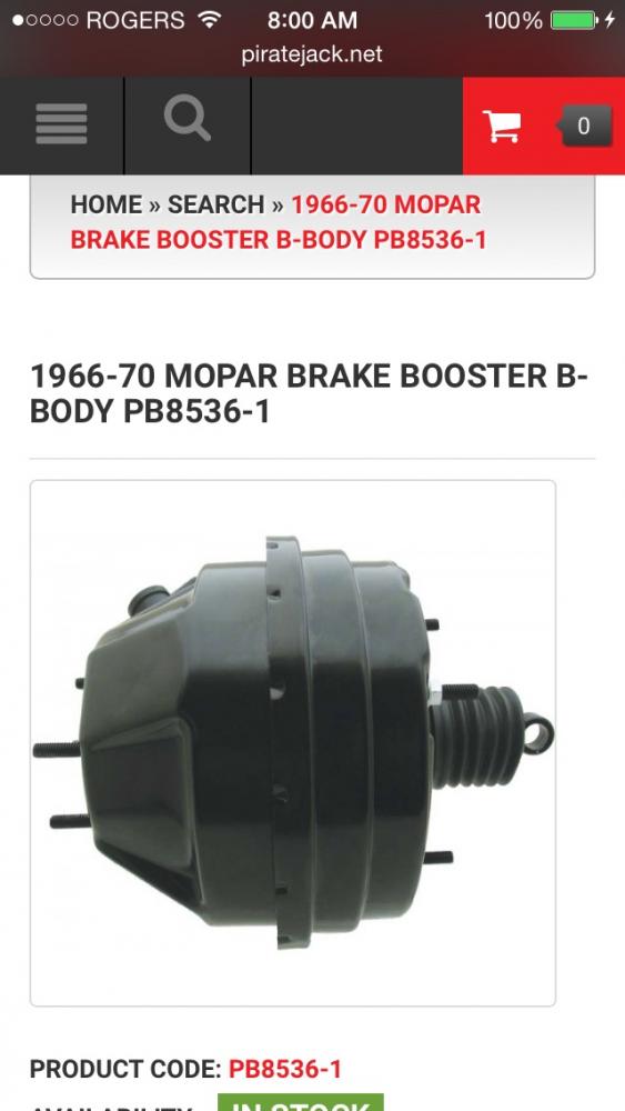

Hey guys i ordered wilwood disc brakes front and rear for my 1969 superbee but not sure what master cylinder and booster setup to go with? I like the stock looking power booster, saw them on pirate jack website but not sure what direction to go. Any help would be great. Thanks

Thinking about going with the pirate jack booster and a wilwood master cylinder with an adapter to make it work. Any suggestions on this setup. Thanks

Havent read any posts of guys having any luck with the wilwood stuff on mopars. Pedal feel and problems With getting the power booster/master cylinder combo right. Im gonna go with a 1.125 wilwood master cylinder disc disc setup and pirate jack factory style booster and cross my fingers
