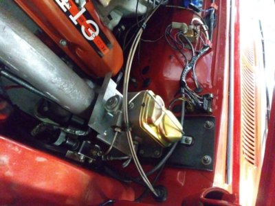

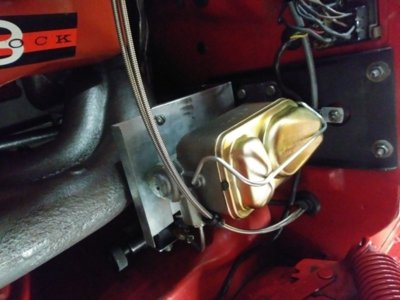

This may help you. I just went through this with my 62 Belvedere Max Wedge. I'm running Willwood 4 wheel disc brakes. I had a 1"bore master cyl for 4 wheel manual drum brake 67-69 B Body set up on it. Brakes were OK but pedal was hard and was hard to stop quickly. Went to this(in photo) Raybestos MC36406 (73-76 A Body w/frt manual disc brakes) with a 15/16"bore and now have good pedal feel and much better stopping. This MC also has groove in rod hole to lock it in place for manual brake stock push rod with rubber grommet. Clearance with Maxie manifolds is good. I made my own heat shield out of bright finish tin sheet stock and mounted it to the lower 2 firewall reinforcing plate bolts under the MC. (500+ degs. at exh manifold and 130 degs. at master cyl). Heat shield really works well. Don't use the stock OE heat shield as its only for the old single resivoir MC and will not be long enough.
Almost forgot. If using the MC36406 you must drill or melt a hole through the rubber check valve in the front outlet port. Its there because this cyl is for a rear drum brake set up. The rubber check valve holds 2 psi residual pressure for drum brakes. You don't want any residual pressure held in the line for rear disc brakes. I usually just heat a small drill bit up to cherry red and stick it in the outlet brass seat hole and melt a hole in the rubber check valve behind it. That way there is no need to pull and drive the brass seat out and back in. This goes any time you are using a drum brake MC for a disc brake application.

This looks to be just what the Dr ordered. Just wondering if it's possible to raise this assembly, maybe 1/2" to give it a bit more space from the heat ? What's your thoughts on that ? I threw in a few pics of where it will be sitting in the future
Really don't see a need to raise it. With heat shield your MC stays at normal underhood temps. I've been running mine 4 years with no problem. I only swapped to the new MC because I wanted better pedal feel. I'm streeting a pretty strong DLI 440 long block with 3705 Eddys at 576 flywheel HP with no heat problems.
