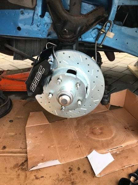

There are basically 2 ways to go. Either swap the front drum brake spindles for disc brake spindles and use mopar parts or use your drum brake spindles with an adapter plate that allows you to mount non-mopar rotor and caliper. If you are doing front end work also, then swapping out to a disc brake spindle won't require additional work as you will have to disassemble the front end and get a wheel alignment anyhow. If you just want to do a fast swap with no front end work, use an adapter kit. In either case, you will have to get a new disc/drum master cylinder and install a proportioning valve so you don't get rear wheel lockup. There are multiple threads you can search the forum for which detail different members' swaps. I used an SSBC kit on my 70 Satellite. Everything fit perfectly on the drum spindle and no front end work/alignment needed. I used a Right Stuff 15/16" bore master cylinder from Summit. Car stops straight and fast, great pedal and not too hard for a manual brake car.

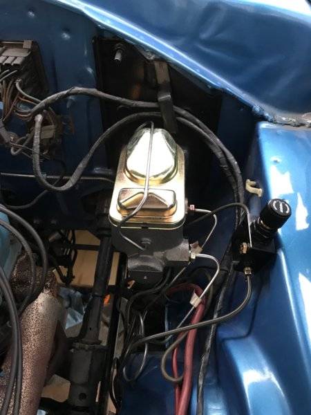

Note where njrr mounted proportioning valve. Another option is under dash, a member did it that way. Buy a double flaring tool, it's a tool when you need it you really need it.
Where I put it seemed the easiest. 2 short pre-made lines with only a couple of bends and loops to plumb it into the rear line coming off the distribution block. Mounted it in a very accessible spot using an existing hole in the fender. Under the dash seems like it would be harder to plumb and also if it leaks you get brake fluid inside your car. Maybe easier to adjust, but once it's set, I don't see a need for easy access. One reason would be to keep the engine compartment totally stock looking, but that wasn't a factor for me.
