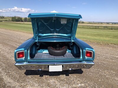

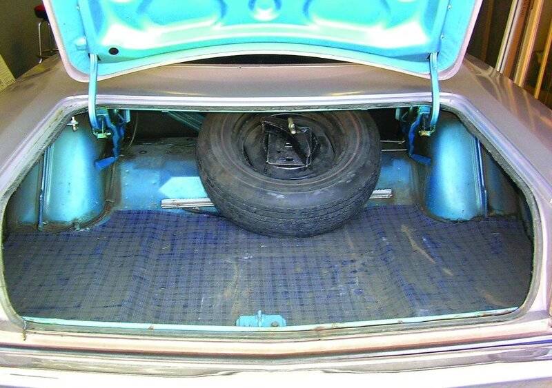

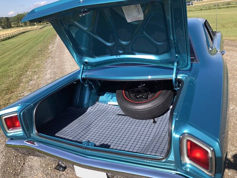

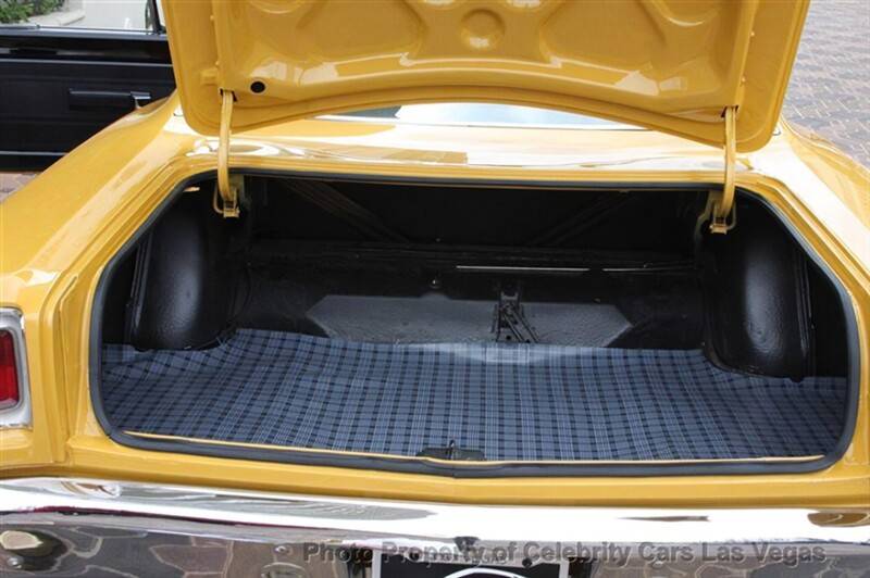

Curious how the jack assembly and spare tire are meant to be displayed in the trunk of this 69 Road Runner? It was clear to me with my 69 Dart exactly how everything was supposed to be stored in the trunk, but I am not as clear on that with the Road Runner. Would appreciate a few pictures if anyone has them. Thanks.

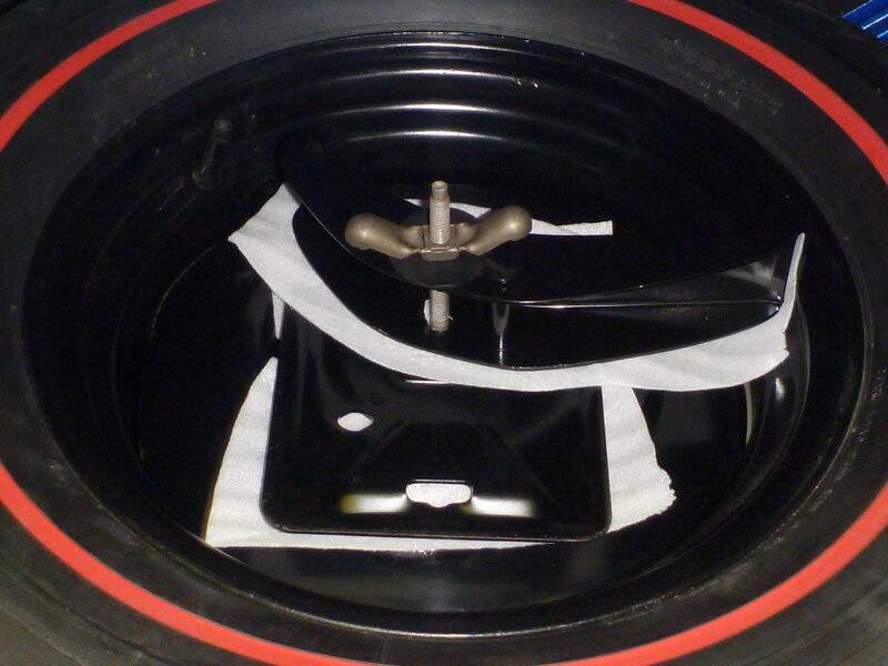

This how they are stored. If the trunk floor has been replaced there is a possibility that the mounting bracket may not be there..

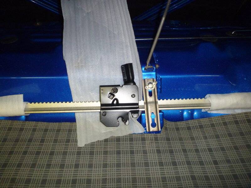

This is the mounting bracket and the other bracket that goes with it..
