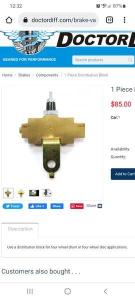

I have 4 wheel disc conversion. I bought a 4 way disc distribution valve. Do I just use the inlet and 2 of the outlets and block off the other 2? And I'm guessing the back brakes just connect to the one line to the back til it splits? Sorry I'm just drawing a blank
Just one line goes to the back of the car.
one goes in, 2 go out.
It’s has 5 ports on it right? 2 in from master cylinder, 1 to the back and 2 out to the fronts. And a spot for the brake pressure light switch.
Yes it's this one. It seems like all the threaded holes are different sizes. I don't see a spot for a break light. It is etched for inlet. But that's it.

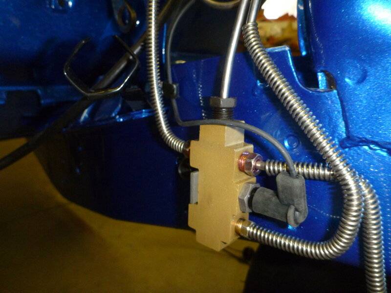

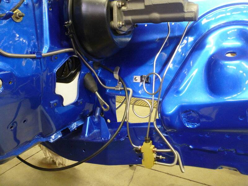

The brake light hooks to the switch that looks to be pre installed. The black plastic and metal part with the threaded stud. All the other ports are used for the brake lines and none should be blocked off.
That's just a regular old distribution block. Front brake line in the top, out to both front calipers on each upper side. Bottom brake line in the bottom front hole and out the rear. The internal spool will shift if front or back brakes give out activating that switch.
