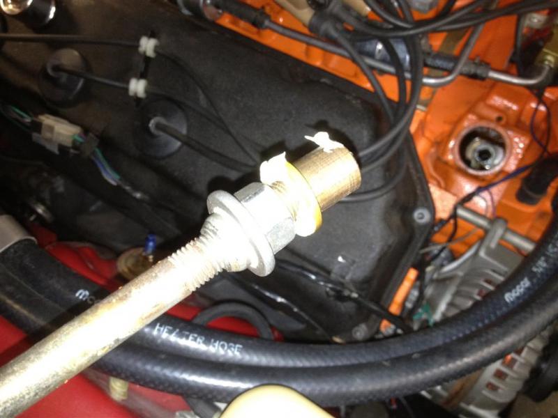

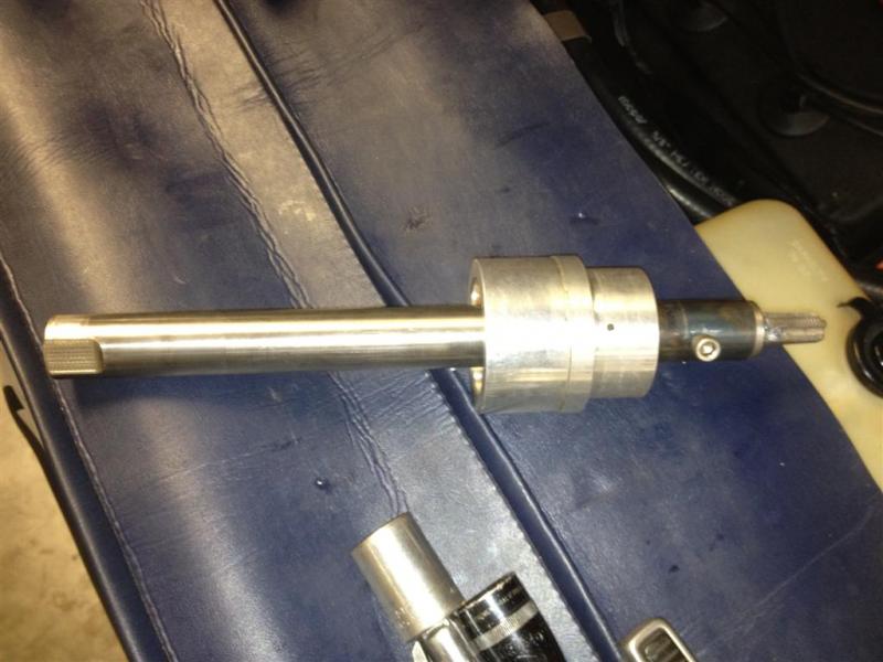

I had no idea about this tool, but when I was in your shoes I just made a tool out of junk - but I do have a machine shop at my disposal. I found out my bushing was very worn by using a big screw driver to twist the gear and I saw it move in ways it shouldn't have. So I pulled the shaft and did some wiggling by hand and sure enough it was toast. My tool uses a 1/4" pipe tap to cut threads into the bushing then a slide hammer with a 1/4 pipe nipple fitted to the end to pull it out. I packed the tap and bushing with grease to keep the chips from going into the engine. Worked slicker than, well, a greased distributor bushing! Installation was just as easy and I used my tool with the guide and a pilot to start it straight and drive it home. This was in my 66 hemi Charger.
Forgot pics
