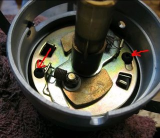

I have the Mopar Performance electronic Ignition on my mild 360. For the past few weeks the over all performance has crashed. I checked the timing vacuum timing works fine, but that's where it stops. If I go WOT it stays where the vacuum maxed out at?
I was doing some research and a lot of the time the mechanical advance springs are bad? Do i need to replace them or put some weaker ones in?

If you point a timing light at the balancer, (with the vacuum advance line removed and plugged) what is the timing at idle? When you slowly rev the motor, does the timing mark move?
If the mark doesn't move when you rev it (no need to go over 3,000 rpm or so) it's an indication that the mechanical advance weights are probably stuck. Unless you messed with the springs before it started running bad, those aren't the problem. You can take the distributor cap off and grab the rotor and turn it. When you let go it should snap back, showing that the weights are free and the springs are in place. If it doesn't snap back, a few well placed shots of WD-40 (with a straw) aimed at the weight pivots should help. If not, it's pretty easy to disassemble it and clean and lube everything. Good luck.
Adding and removing the Vacuum advanced didn't change how it idled? I had the timing at 13 degrees above the 0 in the timing belt that read -10 0 10 My timing is at 13. According to that <-
When I took out the vacuum advanced, it didn't change and when I added it no change at all. However it would still advnace by 10 degrees when i brought it to 3000 Rpms.
The vacuum advance is not changing because its not getting vacuum. Right now dont even focus on that. If your base timing is at 13 degrees and goes to 23 at 3k
rpm, try seeing where it is at 4k rpm. It returns to 13 at
Idle correct?
Once it hits 23 degrees and I rev it up it stays at 23 degrees and doesn't go higher. When i let off the throttle it does go back to 13.
Do I need to adjust the diaphragm in the vacuum canister?
No. Forget the vacuum advance right now. You are having a mechanical advance issue. You only have 10degrees of mechanical advance. The mopar performance unit is adjustable. But a pain to get to. The mechanical advance plate is below the pick up and vacuum advance plate.

Since the rotor snapped back we can assume that the advance mechanism is working. The rotor will only turn about 1/8 of a turn due to the advance stops. It sounds like someone may have modified the distributor so that the advance is limited to 10*, which is a very common tuning trick.
Your total advance is not near enough at 23*. You should have about 34-36* total, which is pretty much impossible to tell if you can't see the timing mark. It's also possible that the outer ring on the balancer may have 'slipped' and that's why the marks don't line up.

One thought, since I don't think it's been mentioned.
>I did that and the rotor did snap back, well it wouldn't torn freely*<
On any advance, but critical on a mechanical advance, sounds like the advance rotor could be dry, and dragging. Those things need to be taken apart, cleaned and lubed using a high-temp grease. I guess you can still buy that stuff.
I would be happy having only 10 degrees of mechanical advance if i were you.
You should be seeing or setting the total between 34-38 degrees i would think.
I would see how high i could set the initial timing till it kicked the starter back @ 'operating temp' and then back the timing off a couple degrees from there and set it, thats usually where it will make its best low end punch. After the initial is set, then adjust the mechanical advance to only add as many degrees as it takes to be at it's full advance sweet spot like mentioned above= 34-38 mech adv
