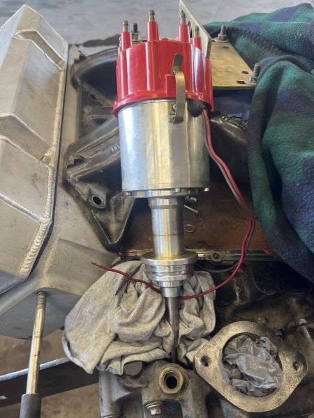

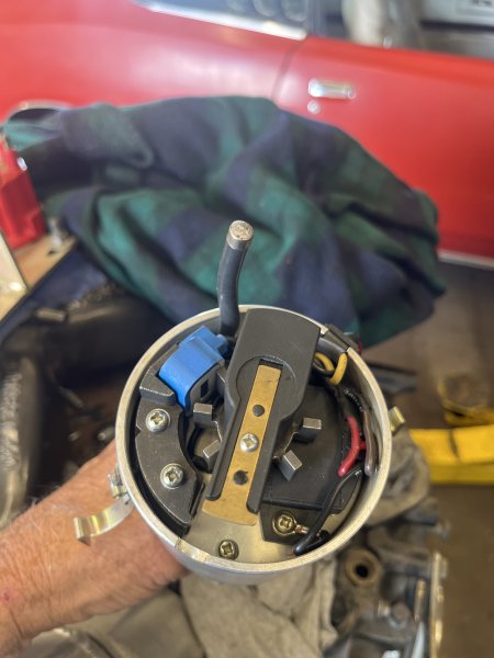

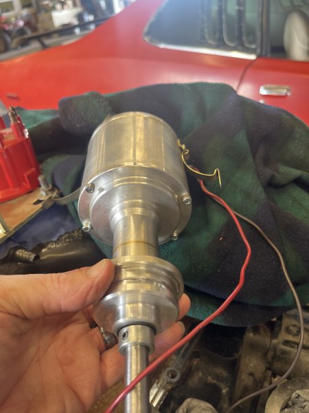

No markings that I can find. Appears to be a fixed distributor with no vacuum or mechanical advance. Can this be used on the street or is it strictly track/race?
Thanks in advance!

I don't recognize the distgributor, but I am guessing the mechanical advance is below the plate that holds the pickup. Most likely you have the choice for advance or locked out, but you will have to take it apart to see what you have. Kind of neat because it looks like a magneto from the outside, so would be great for a nostalgia type AFX car.
That looks to me more like a "ready to run" distributor than a "magneto" - particularly since it has a reluctor wheel. For what little I know about distributors !!
Is that a coil lead sticking out of it!?
In post #1, it looks like it has a module in it, similar to a HEI module. So my guess it is not magneto ign [ wouldn't need a module ], but magneto-look-a-like.
Some sort of billet electronic distributor, new one on me ford? internals?
The proper number is PCE376.1023 speedmaster.. looks like they don't make it anymore.
