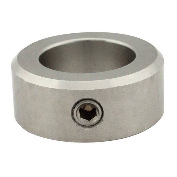

The original Nylon bottom retaining ring is not anymore available on market but can be replaced with aluminium pieces available at hardware stores. Just like this:
(I think they are available even flanged)

Watch them. I have seen them throw the hex lock. Get something you can use a roll pin with,
