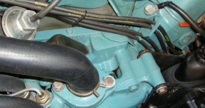

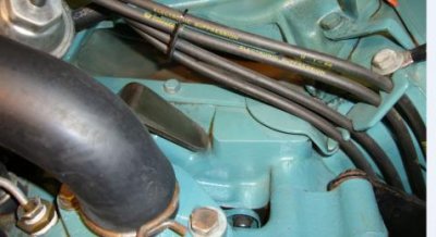

i have a 440 and it is straight across in the front, not too sure bout the 383's. if memory serves, i dont think there was a 383 RB motor. RB stands for raised block, where there's more meat on the top of the block and heads. easy way to tell if you have an RB, look behind the water pump neck for a square chunk of steel. see it next to the distributor hold down?
pics...

MarPar is correct, the 383 was always a B engine along with the 361 and the 400. The bottom end of the B engine is the same configuration as the RB, for example they shared the same oil pan.
There was a 383 RB, but it was only built for a couple of years, something like 1958 or 1959 through 1960. It was never put into a B body though, since it pre-dates them.
That being said, odds are it's not a 383 RB. You would have to check casting numbers and such to be sure.
a 383 RB is a relic of history and is dimensionally the same as a 440. It will also have the 440 ID pad like in Mar's pic above. All the lower end features for B and RB are the same.
