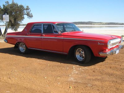

Howdy Fellas
need to get behind the dash to replace wiring and have heard I need to to remove the screen ,is this correct?
Car is a 63 Dodge Phoenix here in Australia but I believe a Dodge 330 sedan in the US.

Unless you got really super tiny hands, pull the windshield out, it makes the job easier.
Now, me being an old guy, I'm always looking for the easiest way to do things. I removed my dash in my 63 Fury with the windshield (screen) in place. I'm no small guy, but it was a piece of cake. If you do a search on this site you should be able to pull up my description (as well as others') of doing it. I would guess the Dodge & Plymouth are similar, since they take the same glass. Good luck!
