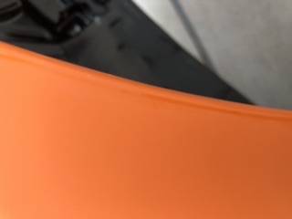

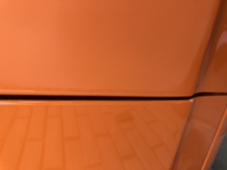

Hello, to say I am anxious about taking sandpaper to my newly painted car is an understatement....but I am proceeding slowly after reading/watching others do it. My paint came out quite flat, so I am hand sanding with 1500 grit on a 6” thin durablock. It is taking very little effort to flatten the paint.
My question is.......I have a thicker build up of paint/clear around the door edges and fender edges.....Do I keep flattening the paint so close to the edge, or do I simply leave it, polish it and not risk cutting through to the base coat on the edge. It has taken me the better part of a year to get this far and do NOT want to have to repaint. I have enclosed a pic to make it more clear.

which panel is it? Normally you mask the edge so the risk is not there. Also not sure what you sanded with. Or how many coats you applied of clear. 1500 is a little coarse. You may have to go 2000 wet. Then 3000 wet Providing you have enough material there.

They can be worked down but use 2000 wrap on a 3 or 4" piece of paint stick work up and down and here is the main thing.
When that little light starts flashing in your brain { warning } stop sanding. Your not going to remove it without sanding through the edge. Your just trying to dumb it down / blend it into the panel. The soft block will screw you over on a edge.
Thanks for the replys. I sprayed 4 coats of clear, and I don't think it is an issue of not spraying past the panel ends. I think like KD says, it is just builds up a little more around the edges as the clear flows out. I will use a paint stick and sand flat around the edges and see if I can bring that ridge along the panel edge down. The first pic is of the front fender well, the thin shiny darker looking line is simply the paint that has not yet been touched by the sandpaper because of the higher ridge right along the fender edge. Second pic is between front fender and door, showing the same issue.
you can knock that down no problem........do it by hand, no block....... just a small piece of paper on your finger tips
