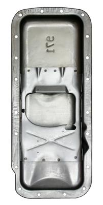

Is a 971 pan completely nessasary?
I need to replace the pan on my 440 out of my 74 this winter. Was wondering if its nessasary? Having a hard time finding a source for them new. But the pre 71 pans are cheap and readally available. Thanks

Thats great, but in a 74 everythings different, k member and steering wise. than the 68-70 so in a nutshell whT BB pan will fit my car. That i can get affordably.
None of the older stock pans will work including the 187 which WILL hang up on the ISO K frame. The 971 sump is smaller at the front by almost if not a full inch to clear the K.
So the SUM-G3543 will work. Thanks guys
after looking again, between the two pictures, i would call summit to make sure that the summit pan has "exactly" the same dimensions as the 971 moroso pan (which is just a MP oil pan with a moroso sticker on it).
