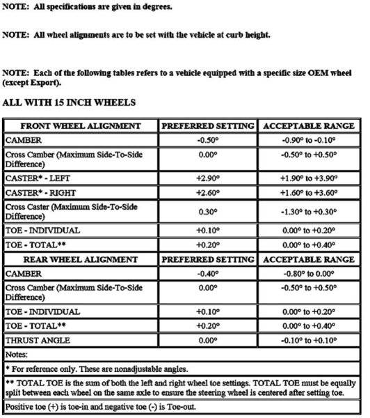

Most cars on the road are out of preferred alignment specs. The things that affect alignment changes are ride height changes, Condition of suspension components, . The alignment angle that allows the car to "pull" is caster and can cause minimal where if excessively out of specs. Camber angle and toe in/out are the main sources of tire wear and are usually not "felt" like caster is. So thinking that the alignment is good because the car goes straight when releasing the steering wheel is not true at all. But the tire people love to sell you more tires. If stability was good before the swap and you are using the same rims as before, check your tire pressures. The larger tires will need less pressure because of their increased load capacity. High air pressure can induce wandering at speed. To be sure though, I would have the complete alignment checked including camber, caster, toe, And thrust angle. All modern equipment measure those angles and a good alignment shop can adjust all angles. Don't go somewhere that only knows how to set the toe. On modern cars that is the only thing adjustable most of the time.
View attachment 774118 Most cars on the road are out of preferred alignment specs. The things that affect alignment changes are ride height changes, Condition of suspension components, . The alignment angle that allows the car to "pull" is caster and can cause minimal where if excessively out of specs. Camber angle and toe in/out are the main sources of tire wear and are usually not "felt" like caster is. So thinking that the alignment is good because the car goes straight when releasing the steering wheel is not true at all. But the tire people love to sell you more tires. If stability was good before the swap and you are using the same rims as before, check your tire pressures. The larger tires will need less pressure because of their increased load capacity. High air pressure can induce wandering at speed. To be sure though, I would have the complete alignment checked including camber, caster, toe, And thrust angle. All modern equipment measure those angles and a good alignment shop can adjust all angles. Don't go somewhere that only knows how to set the toe. On modern cars that is the only thing adjustable most of the time.

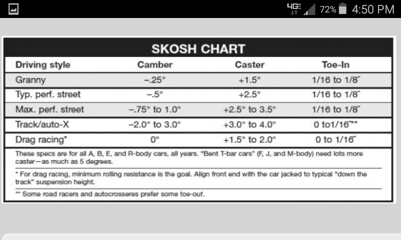

Thanks for all the comments guy's. Now to find an alignment shop that knows old school Mopar alignments and are close to me in Cincinnati. The
guy that did my alignment a couple years ago doesn't run the tire discounters anymore. Since I have manual steering would I still shoot for -.5 on the caster
and +2.5 on camber and 1/16 - 1/8 on the toe in on the specs? Man I wish I would have mastered this years ago, this is one of those services best to do it yourself if you have the proper tools and some knowledge. I did raise the front end back up close to where it was before lowering down. I know the alignment's not too far off that's why I want to try and do it or check the alignment myself. Thanks, Dave
