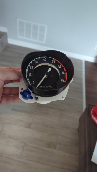

I'm replacing a miscalibrated tictoc with the charger specialites tach.

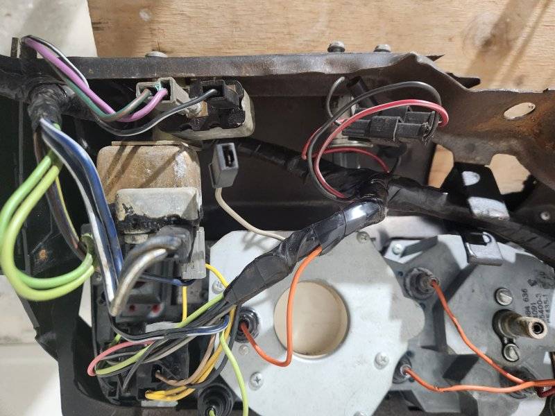

yes back side 3 screws , this has blank but same thing.

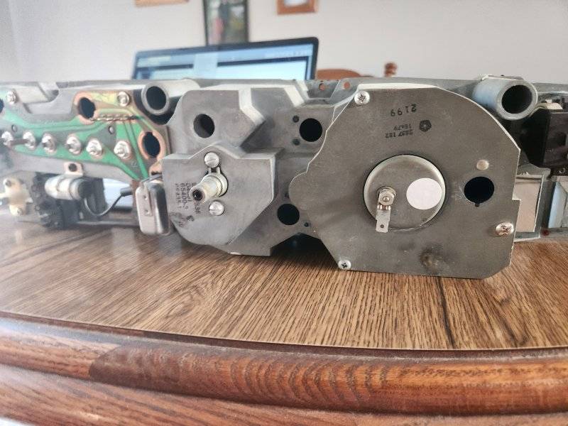

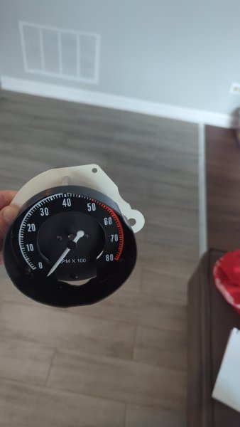

Dave's photo has screws coming in from the back side on the blank. My tach has no threads in it's holes.
It would be handy to have a spare to look at, because the 2 sets of photos seem to contradict each other.
I'm missing something.
here you go ,I added a clock to my Charger
Remove three screws from rear and adjust knob from the front....the tach comes right out the back. As suggested, all other gauges come out the front after removal of clear lens.
I've done it many times removing it from the back. You don't have to remove the cluster. Just patience and 3 screws. Easier if you remove the drivers seat.
