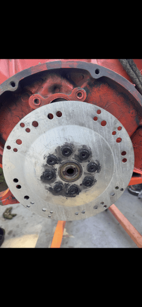

We got one overnight shipped. Not an expert on these things and I’m helping my dad out. So turns out now the crankshaft was the 8 bolt but doesn’t fit the 727 looks like it was made for a 4speed. Is there a way to make the 727 fit? Removing something? Or is changing the crankshaft the only way?
Just take the pilot bearing out of the crank. What is all the gray stuff smeared around the bolt heads? I hope thats not ARP thread lube. If it is take it apart and clean it all off. I use Loctite.
