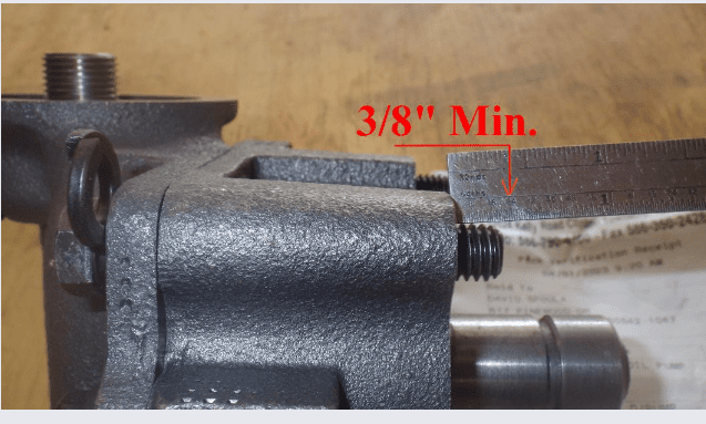

For those of you having trouble with the video the bolts needed are (3) 3/8 by 3 and (1) 3/8 by 4.5.

I usually have to trim down the three 3" bolts so they don't bottom out in the block holes.
Thank you for pointing that out. With a standard pump this would more than likely be needed, but I did not have that issue with a high volume on my 383. The original shorter bolts for the standard pump were about 2.75in long, so this would make sense for that application.

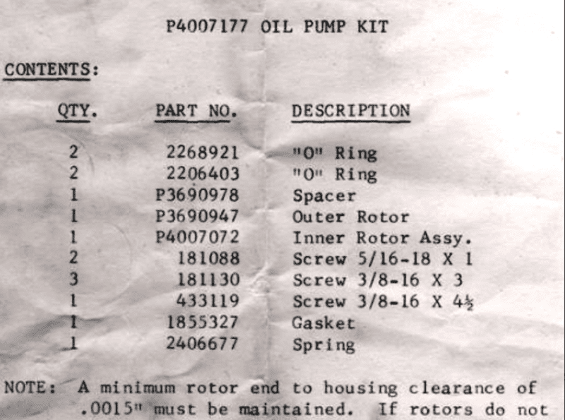

Some more info for WIW.
DC use to sell a long pump rotor and plate kit. It came with 3" bolts and the 4-1/2". Those 3" were too long as well.
Interestingly, I recently purchased a HV pump from Mancini along with their recommended bolt set for the HV pump.
I received one 4-1/2" bolt and three 2-1/2" bolts which are too short. Believing they sent a standard pump set I called them and they claimed their bolt kit came as 2-1/2" and the 4-1/2". Live and learned there.

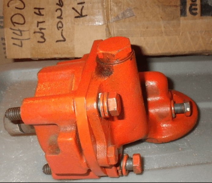

I see the double washers on those 3" bolts :)
I always trial fit the bolts without the washers. If the bolt bottoms out you can see/measure how much it should be shortened, or how thick of a washer you will need.
Lol, I still have that pump as you see it. A swap deal came about way back where I didn't need to use it.

I use the "1 to 1-1/2 X the bolt diameter" for thread depth engagement.
