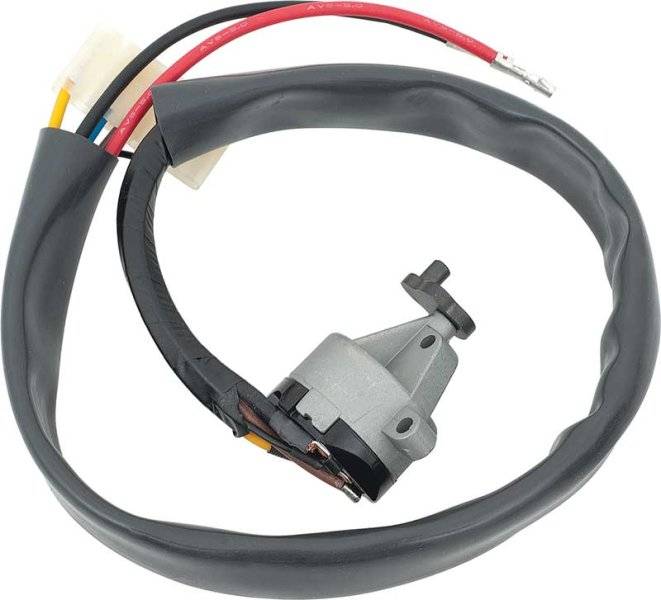

Aftermarket is junk. I'm on my 2nd ignition switch on my 1971 in 4 years, and it's acting up again! It's not a fun replacement job being in the steering column. I won't keep replacing it with more junk. I plan to bypass it and use a MIL-SPEC momentary toggle switch...good enough for the US Military, good enough for me! The junk switch will just be to lock my steering column. I hope it's up for the job. I work in the wire harness industry and thought about making a simple lay-over (I'll call it) harness for for just the ignition system. The mopar wiring has many issues, but can be bypassed easily. I'm not up for the $800 Painless wire harness when it's really just ignition and charging issues. Thoughts?

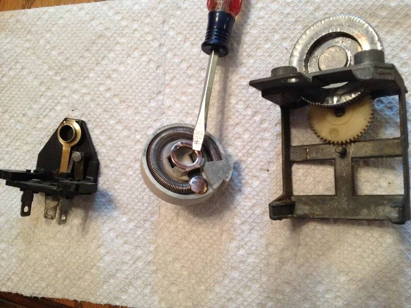

I have never rebuilt an ignition switch, so I can't speak specifically for that. I did, however, rebuild my OEM dimmer switch when I restored my 1970 Road Runner, and it is still going strong. My dimmer switch really just needed to have the contacts cleaned well. It wasn't made to come apart, but I gently pried up on the metal frame and got it apart.
If it were me, I'd try to fix the original switch - seems you have little to lose!
I rebuilt the dimmer switch on the Coronet. Same thing as you, mainly just needed a good cleaning. I remember having to replace the OEM rivet with a small nut & bolt.

Impressive, nicely done!
