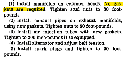

My motor is almost done and I do intend on using exhaust gaskets but i did notice the factory manual says they are not needed. What does the B Body community do? Gaskets, no gaskets, or gaskets and sealer like copper rtv?
I'm very interested to see what the opinions are here, and as always thanks in advance!
If the manifolds are straight and not warped, no gaskets. If warped then chuck the manifolds or have them milled by engine shop. Confirm with a straight edge. If headers then use copper gaskets.

There's no reason to re-install a warped manifold - fix it beforehand, as already mentioned. On the drag car, I use the hi-temp silicone instead of a gasket, but if it had to come apart often, I'd use a gasket.
Cast iron manifold and heads - no gasket just a smear of high temp RTV on the sealing surface.

Just bought a system from accurate exhaust, and they told me "make sure my manifolds were flat, and don't use gaskets, that's what cracks cast iron manifolds." So I just did what they said, and no leaks.
