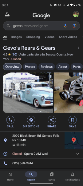

This is our local specialist.
He's done thousands.
You could give him a call he's a good guy.
