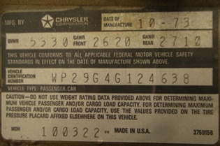

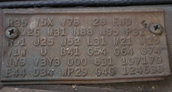

This i how the car looks right now. But what kind of windows do fit in the rear area? Is it possible to make them movable? The problem is, I don´t exactly know how the car came out of factory, so I´ll post a picture of the VN-Plate, maybe it helps....

You have a WP29 on your tag. That's a 73 SE which had fixed rear side glass. I might have those pieces, but I've moved since I last remember seeing them so they might not have survived but I'll look for them.

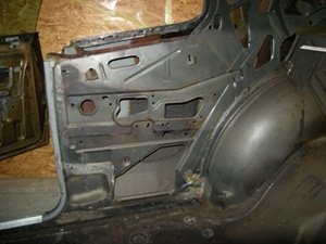

Some had roll down windows too very few take a picture of the inside metal is there a place for a window regulator someone might of converted it to a hard to style setup I believe I still have the parts you would need left around here p.m. me and we can talk

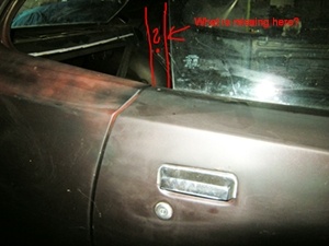

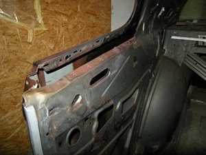

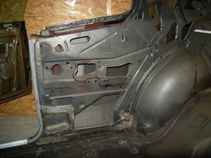

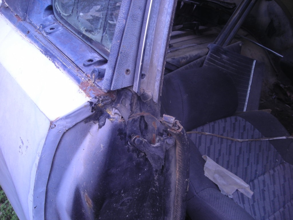

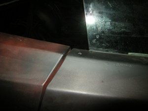

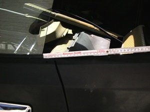

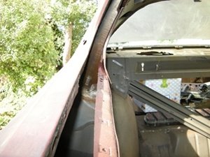

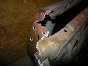

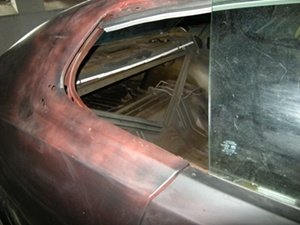

Thanks for all your fast and helpful replys. I took some more pictures of the car today.

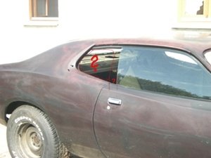

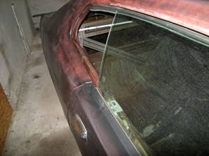

If the car originally came with fixed windows, it seems to me that some owner before me already cut gaps for movable windows. If it its possible, of course I would prefer to have them movable, so the whole side can be opend without a B-pillar (or is it called B-column?). But otherwise I could live with stationary windows of course. What I don´t really want is putting back the opera-windows wich seem to be originally on the car with vinyl-roof.
I still can´t imagine what belongs in the gap between front an rear window. I marked it on the pictures.
Like I said before, I´m glad about every suggestion and/or possiblity to purchase the missing items....

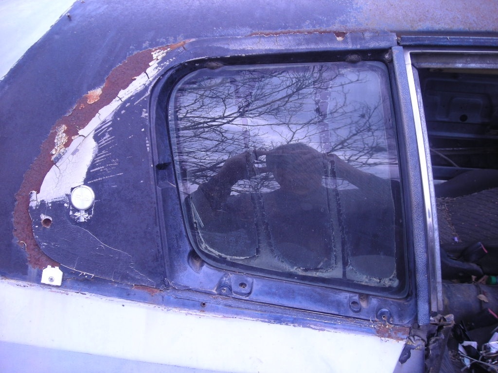

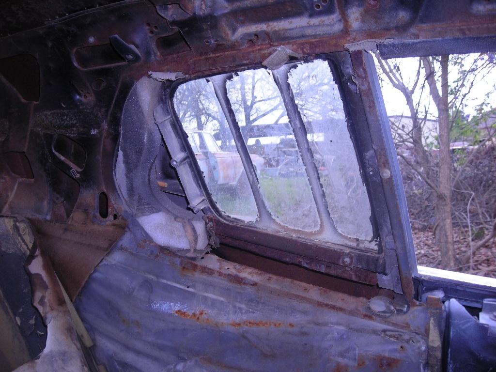

It appears the previous owner has cut away metal which was the vertical support for the leading edge of the opera window, and the point the upper roof rail trim fastened against. You might be able to have roll down rear windows by using parts from a donor car. Will take some work to get everything aligned, but should operate correctly after fitting and welding. I am not at my garage, but have a picture of my SE during body work. The picture should show the filler to the rear of the opera window, and the vertical support that was removed. Should get over to garage by end of March.
Hmm there's a mighty big gap there I will make a call to a guy with a hard top and a s.e. and see if I can come up with a fix for you you might need to go back to s.e. louvers to fill that gap . Just scraped an s.e. car that had all of the stuff you would need let me call my scrap guy maybe it is sitting in his holding yard waiting for the metal prices to go back up
There's a big rubber piece that covers the top of the quarter to window junction, where all that sharp metal is. Kind of hard to find.
The "pillar" is really a thin, flimsy piece, riveted on.
The plastic "plugs" that fill in the opening are multi-piece.
Even the drip rail is different on a car with roll down rear windows, not to mention the seal.
It's a much more involved job to convert than you might initially think.

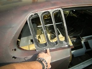

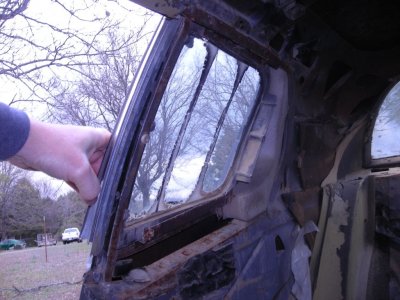

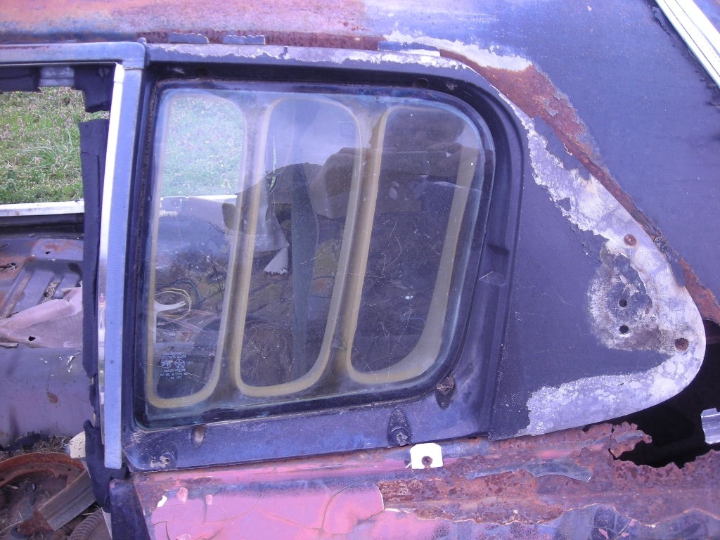

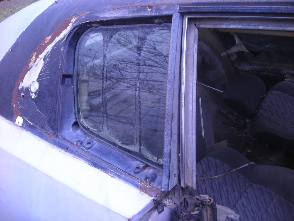

I have everything you will need to put the correct fixed windows back in place as I just brought in a 74 Charger SE parts car.
I am sending you another PM and will email you detailed pictures tomorrow.
Thanks, Steve
I just emailed you some pictures of everything you will need to put the proper windows back in. I am also uploading them here in case they did not come through in the email.
Thanks, Steve

73/74 SE was a higher production model, thus 1973 Coupe windows are not common and difficult to locate. Both models used the same roof section.
They also made an SE that didn't have the fixed louvered windows. It featured the vinal top with a strip of body color above the side windows with chrome moldings following the edges of the vinal top. It had roll down rear quarter glass like a standard Charger.
