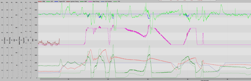

I agree w one of the previous posts to get the distributor and let the Sniper computer control everything. Backfiring sounds like a timing problem to me.
That said - when I did my initial setup I mistakenly did that to the wrong distributor config. It ran but the timing was all messed up and the computer couldn't control (figure out) the timing vs O2 readings and fuel requirements.
I suffered though this for some time and had also sent the Sniper back to Holley - it came back as sent, nothing found wrong. I had also sent Holley my printouts, but because the problem was in the setup . . . the printouts looked OK.
I've attached one of my print outs - This is run down the road. The Hot Pink line in the middle is the timing (22* at idle and 34* at cruise, 0* at crank). You can see how the sniper computer uses the timing and AFR (top bright green line) to respond to Throttle Position (TPS light green line at bottom) and Manifold Vacuum (MAP Dark green at bottom - responds to opening the throttle)
I hope this helps. I'm not a wizard on the Sniper set up, but without it I don't know how to balance the traditional: springs, weights, vacuum advance, jets and pumps. . .
