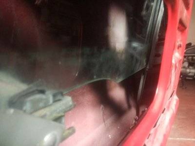

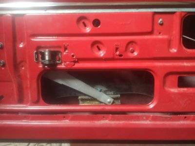

First I was wondering if I´m missing any part on the window mechanism on the car because the window in question goes up but it doesn't go up straight. The window has a hole on the bottom right corner (photos uploaded below) and I don't know if it's missing something.

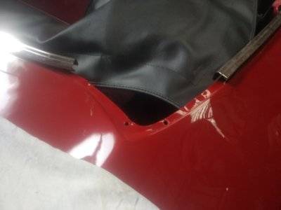

Also, I got the trim for the convertible top of the car but I'm missing the corners.

There’s a plastic stop that goes in that hole in your door glass. I think they are reproduced.
Hey Paco,
1. Crider is correct about those stops (hole in glass). It's a plastic piece (about 2cm long) that goes inside the hole with a screw that goes inside & spreads the plastic piece apart.
2. I still have the convertible corners or you can buy the reproduction set I told you about.
3. The windows have adjustments front/back/in/out which are shown in the factory service manual.
