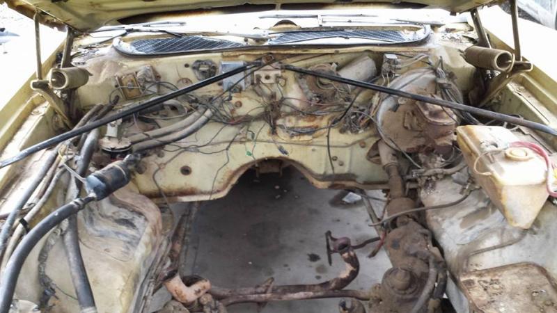

So I've had these summit racing headers laying around for my 1973 Charger for a while http://www.summitracing.com/parts/sum-g9040/overview/year/1973/make/dodge/model/charger . Does anybody have experience with these? My car is a 318/727 column shift car and I was wondering whether I'd have to modify my shift linkage for them to work. The engine and trans are out of the car right now for a rebuild, so I just wanted to hear what you guys think. engine bay 1973 charger.jpg
Since the pic was taken, I've removed the stock exhaust.
