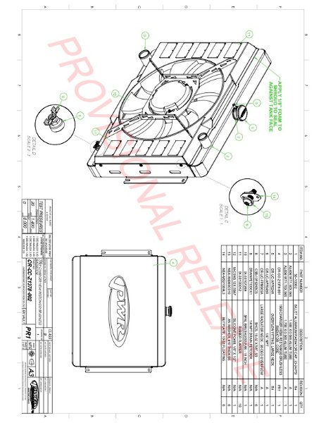

Hello,
wondering if anyone can help me out? I am looking for a dimensional drawing for a 26" big block radiator for a 69 charger. Passanger side top port and drivers side lower port. I have found a couple partial drawings online but nothing complete. Mainly looking for the offset dimensions for the top and bottom hose connections. Appreciate the help.
Ryan

That's a fair question. I am having a custom piece made by a company that does not have an off the shelf radiator for a 69 b body and I do not have the original or a original style radiator in my possession to take measurments.

engine builder instructed that i do not run a mechanical fan. I have seen mixed reviews on the standard twin 11" electric set up that several vendors offer. So I decided to go all out and center this radiator around an 18" SPAL brushless fan that pulls more CFM than anyone needs.

I have no doubt in the factory set up, and yes my engine is stroked and makes 900HP. One of the most well known hemi engine builders told me to not use a mechanical fan on the motor he built for me and I'm going to listen to his advise.
This will also bring another radiator / fan option to the market for others to consider.

Hi mate, howd you go with PWR? i will be using these guys also. did they draw that up for you or is that just a general image? im running stroker with a 6 pack and in the central queensland australia heat, so im needing as much cooling as i can get
They worked with me to make a custom design. That drawing posted above is almost the finished product My plan was to have it bolt into the factory location and use factory hoses. I should have the radiator in a couple weeks. Jason.Smith@pwrna.com will get you set up. Using my design would save you some money. the engineering fee they charge is steep for custom stuff.
Custom radiator finally arrived. The fan is massive, bolts right in like a factory unit.
Sorry, no pics of the final set up. 620 HP 500" stroker. Dual 13" Spals. Dakota Digital fan controller. 165 Amp power master alternator.
Some fine tuning on the controller keeps it down to 200-210 degrees on a 95-100 degree day. 80/20 water/antifreeze mix. Borderline heat issues.
