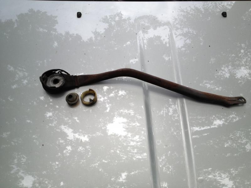

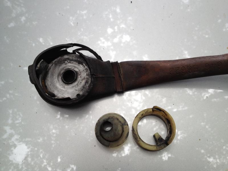

73 satellite 2 speed wiper motor. linkage that attaches to the motor. Does anyone have a diagram ? Pics? What am I missing?:iamwithstupid:

If you have the crank with pin that bolts to the wiper motor shaft then you will just need a small spring with 2 hooks on it that goes down over the pin on the shaft in the middle of the smaller part of your cam in the pic and a tension washer and retaining clip which holds it all together. I have the correct tension washer, retainer crank w/pin and have a correct tested working 2-speed wiper motor as well if you need it. There are two different sizes of those springs a smaller one and a larger one. I have the smaller one but am out of the larger one right now which is what you need. PM me if your interested in any of the pieces
