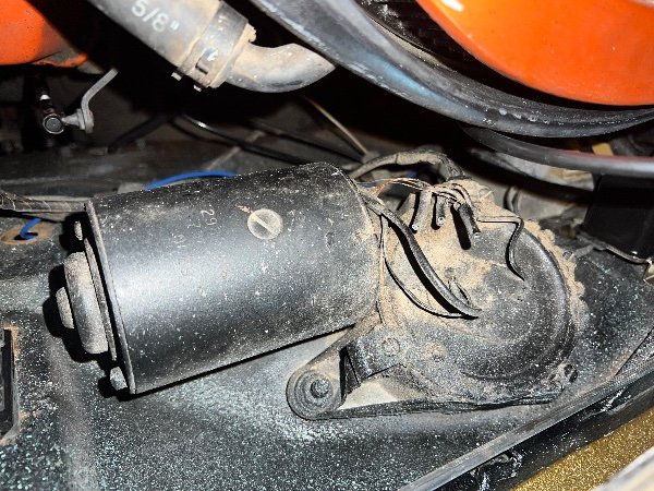

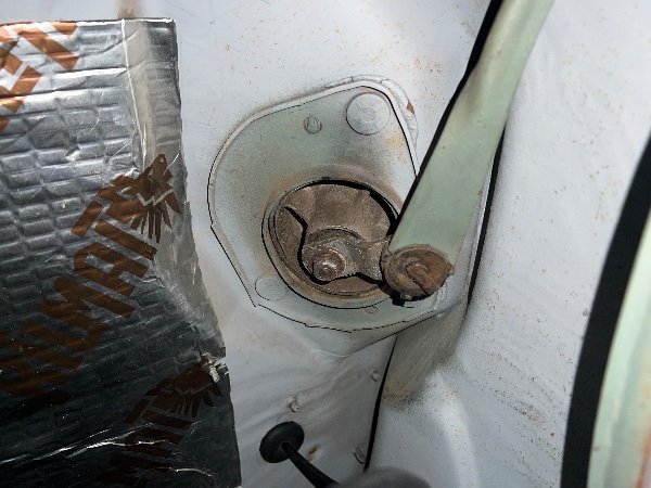

'69 Bee, 383, 727. I have a 2 speed switch, I think - off and 2 other positions. Pretty sure I have a 3 speed motor cuz the wiper motor has no plug, just directly hard wired, although a few wires are cut. I have read a few posts on the differences and am pretty sure my linkage under the dash is OEM but I will confirm when I get home from work. I will also double check the build sheet if it shows it but what is the main thing I'm looking for under the dash on the linkage? The different linkage arms that connect to the motor - they are clocked differently, are different lengths and the 2 speed has a black bushing while the 3 speed has a white bushing? I have pictures of the 2 different arms that connect to the wiper motor.

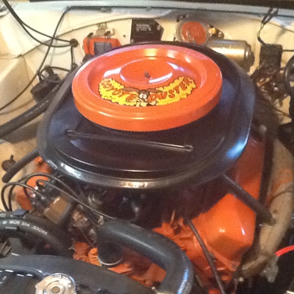

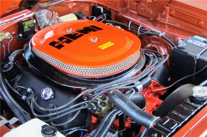

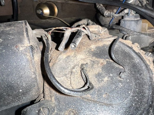

Hi Mikey, with that Ramcharger set up and air cleaner you have, you’d have to have a 3 Speed motor. Plymouth air grabber set up on the bottom ala mine lol. They sale the connection block on EBay and could solder wire and terminals as week if your crafty with a solder iron.
Send me text if you want more info also can get a pic of the wiper linkage that my buddy has Friday for a three setup if you want?
If I’d known this I agree. It’s a 3 speed. The ramcharger won’t fit with a 2 speed. A 2 speed switch won’t work and the linkage arms needs to be changed. I did this conversion on my 68 coronet. Could never find the correct arm for the 3 speed.

The difference on the arm is the attachment to the motor. 3-speed won't attach to a 2-speed and visa versa. It's the shaft. My '69 Dart had a 3-speed wiper motor, and switch, but my linkage was for the 2-speed. So, had to acquire a switch and motor etc.

Yep a 3 speed and like 50+ year old parts the cloth over the fine wires missing but just make sure those bar wires aren’t touching or get to shield them

Also Mikey the part number on that wiper barrel ends in 116 but I’m betting that’s the original one with the car
It was the orientation of the slot on the motor shaft that was different, 2-speed, 3-speed or variable on my Dart. It was attached with the nut, but the wipers could not work properly. I forget now how I caught it, I never go out in rain. Your picture, the arm looks to be attached properly. Your switch, should it have an electric w/s washer? Just guessing the 2-speed was a manual foot pump. Think your getting close to figuring this out.
